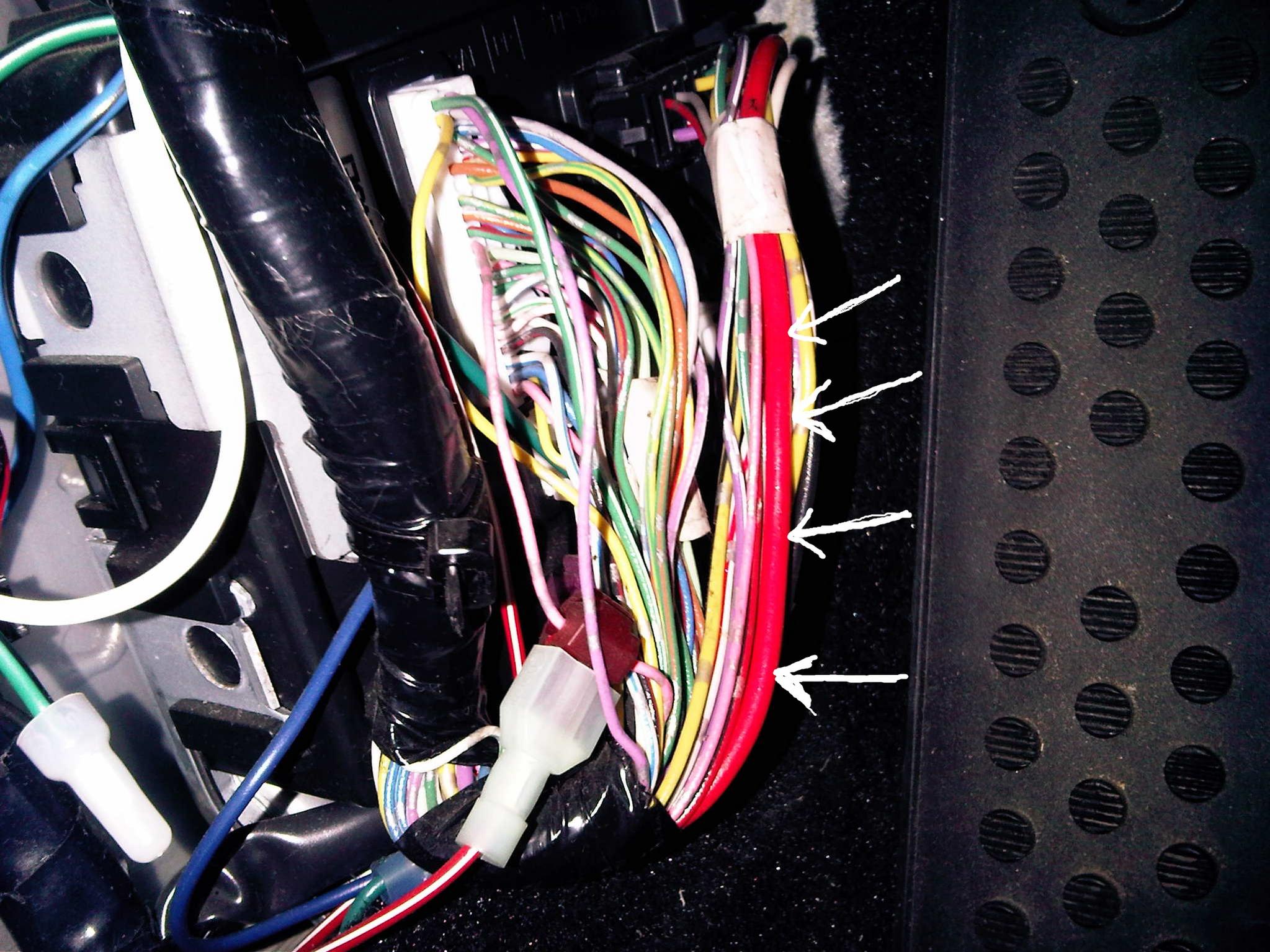

Hey guys, I need some help. Since I have a 06' base, I don't have the homelink rearview mirror, so I have to hardwire it to fuse box. Is this the power wire that I'm suppose to/or can t-tap it to?

If you're going to do that then you are looking for an ACC wire - supplies 12V when the car is on, otherwise your V1 will be running all the time, even when the car is off. I'm sure someone on here can tell you off the top of their head what wire that can be, but you can always use one of these guys:
http://www.2carpros.com/dia/images/test_light.jpg
You can find them just about anywhere you can buy electronic things, say radio shack or home depot or something. They're great to have laying around too for any future project
