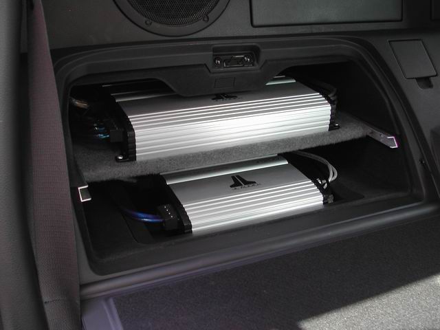

Here is a picture of the one created by my shop. It attaches to all factory bolt holes, and is designed to accomidate additional layers of amps (since I'll be adding a 500/1 for a sub in the future.)
The space back there is huge, no heat problems.

just one quick question on your install. looks like the RCA input and power are running right next to each other. Do you get noise from the power cable?

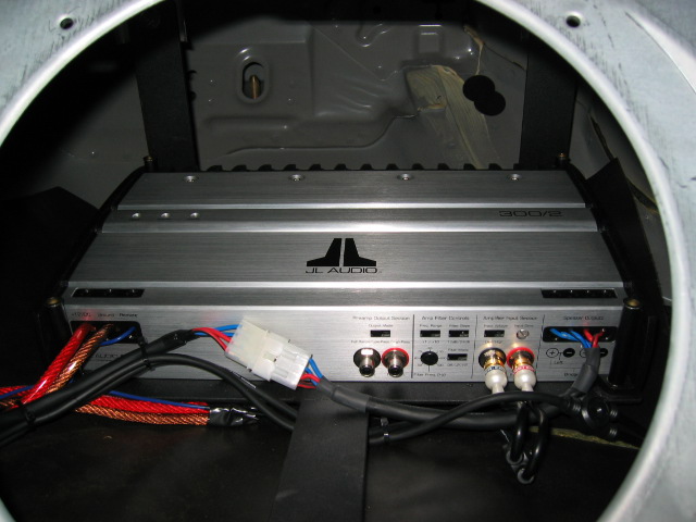

My rack is custom fitted to the exact size of the sub opening, and covered with black carpet to give some appearance that the amps are floating. The entire rack is made of 1/2" mdf, and is attached the the sub enclosure opening using 2 heavy duty L brackets.
Nope, I have no noise what-so-ever.

Monster cables help...I see that Jason used the same cables as I did, and they are a Monster Cable brand designed for car stereo (noisy environments)--they have some built-in noise immunity (shielding) and noise cancelling (balanced) features. I think I paid like $30 for my 9 footer, but in the long run its probably well worth it.

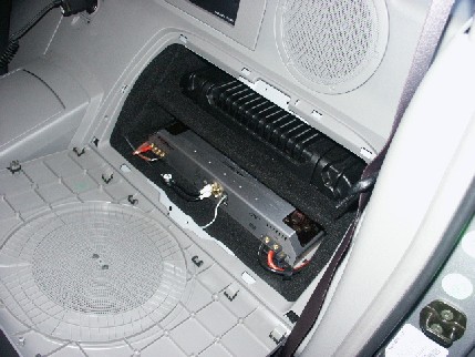

Here's my amp rack. Entire area was fiberglassed and then a sliding plexiglass shelf was installed to hold the crossovers (Boston Acoustic Z6s). Never had a problem with overheating.

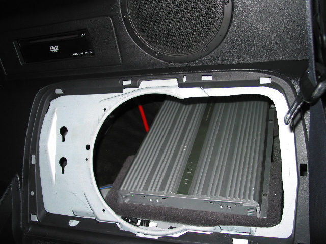

Here's mine, I put the regular cover back on (no grille), installer ensured me that there would be no heat problems.
