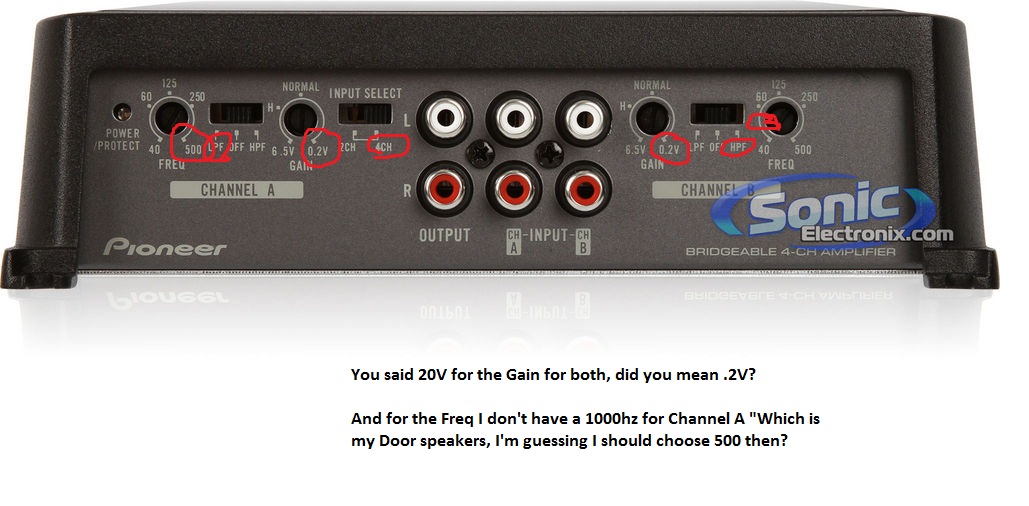

and by 20V you meant .2V right?
Oh no no.
The Freq **** is your crossover (used to filter certain ranges of sound) and the gain is used to match your input voltage with the amp (most people think of it as a volume **** but it's not.)
Channel A put the switch on HPF and put the freq **** to where it points to about the 60.
For channel B put the switch on LPF and set the **** to around 80.
To set the gain you will need test tones to play on the radio. If you have aux input and a smartphone this is easy as there are online tone generators.
You will need to use your dads multimeter on AC voltage on one of the speaker outputs on each channel and set both gain ***** to where it reads 20v on the multimeter.

Since A is Door Speakers and B is Sub? I most likely will be wrong and flipped it backward. ha because you're the guy that knows his stuff. But just making sure since the term LPF and HPF is Low-Pass Filter and High-Pass Filter.

Test both channel A "1000hz" channel B "50hz" twist gain until get 20V on the Multimeter.
Low pass = only low freq can pass through.
High pass = only high freq can pass through.
Set channel A to HPF and about 60hz on the freq **** so it will start cutting out stuff from 60hz and below.
Set channel B to LPF and to around 70-80hz so it will start cutting out music above 70-80hz. It isn't just a block, it just fades out the sound as it goes up. The rate at which it gets quieter is the slope, but you can't adjust that on your amp.
And on the gains, the bigger number is the lowest. Turn them all the way counter clockwise, then when you are playing the test tone at 75-80% your max volume hook the multimeter to the speaker output (with no speakers hooked up at all) and slowly turn the gain up till the multimeter reads 20V AC.
