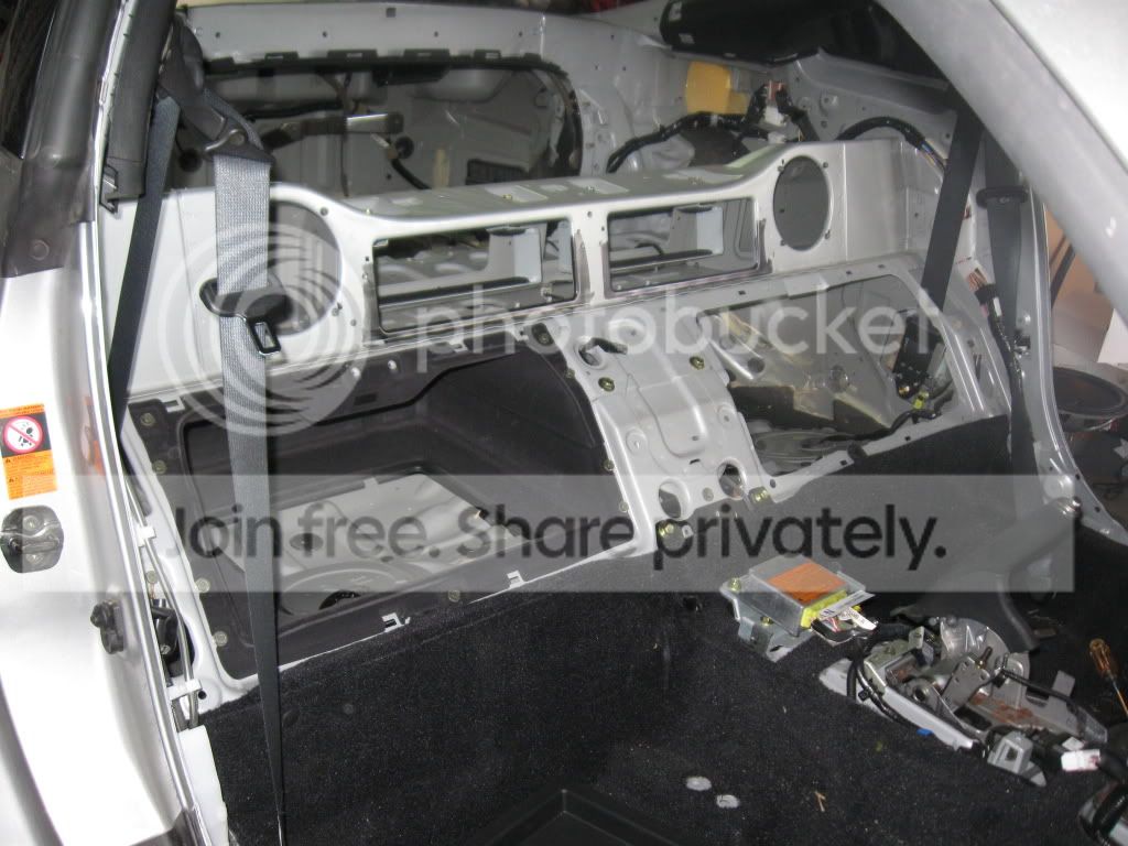

There really isn't room for an amp under the seat. If you get creative you can probably cram 2 amps in the open area behind the driver seat where the factory sub is supposed to go. I put mine on a rack in front of the strut bar.

There you can see the glove box and the open area behind the driver seat. Just gotta be careful because amps can get hot in there.

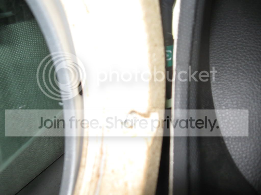

If you're upgrading the door speakers you will either need the adapters that I didn't know about or some 1" speaker rings. This shows the clearance between the ring and the door panel.

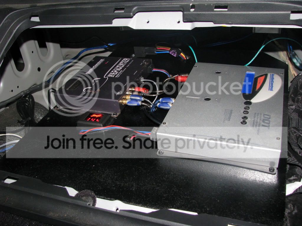

This is a plate I made to mount my accessories on to go in the cubby behind the driver seat.
