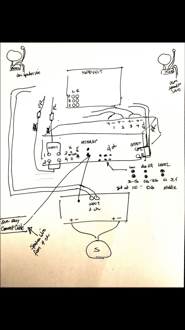

Well i tried to get behind to see what was going on behind the headunit, but was unsuccessful. I do know the rca cables from the input on the sub amp and the output rca cables from the 4 ch are leading back to the headunit. And the output cables are marked R. I believe the rca's going into the input of the 4 ch are also leading back to the headunit. And hes bridged the speaker wires on the 4 ch. I think those are connected to the Blue Easy Connect cable, but not sure.
Messed around with the filters on tbe 4ch and now my sub doesnt work... I changed the filters to Hi instead of Full last night. I also set the bass eq to 0db. Set the hi freq adj to 100. Set the Low freq adj to 100. The headunit doesnt recognize a sub with the filters on Hi. I think it does on Full. But turned that sub level up, and still no sub.
Have no idea how this is currently setup....

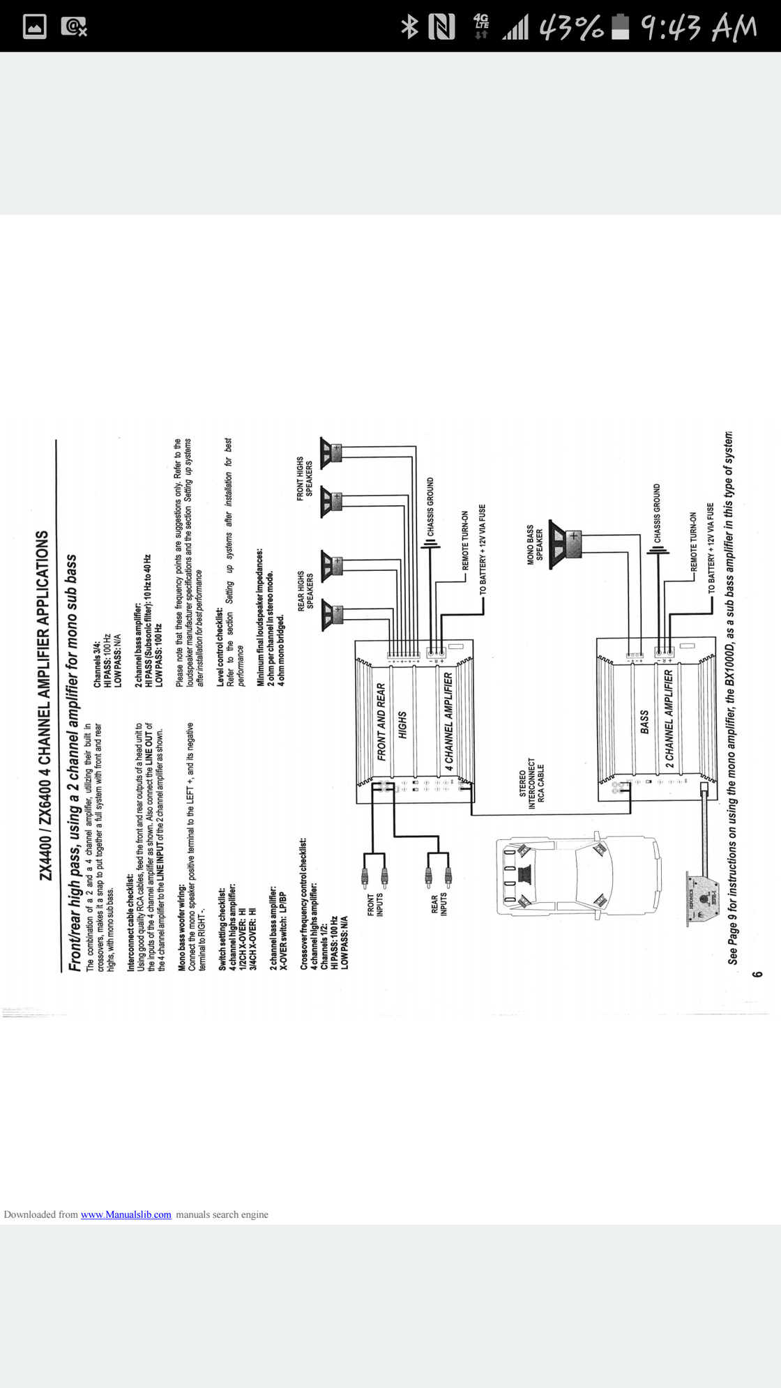

Here are the instructions to the amp. And a drawing of how im supposed to wire it?

Do i connect the outputs on the 4 ch to the passthru on the mono amp if im running rcas tovtbe headunit directly?
You should run your rca cables from your head unit (sub out) directly to the amp that powers the sub.
Your 4 channel amp should be able to work with 1 or 2 rca cables sending a signal.

Your 2nd wiring diagram looks correct with a minor change:
you want Ch 1 & 2 to have the Front & Rear LEFT signal going to it, while Ch 3 & 4 have the Front & Rear RIGHT signal going to them.
this way you maintain your stereo sound.
The easiest way to check is to move your fader control. If its done correctly you should be able to fade right and left, (and the sound should move accordingly) but as you fade front to back the volume level should drop as you move away from the middle.
The front speakers (both channels) should be on hi-pass @ 100 HZ and the sub should be set to low-pass @ 100 Hz. However if the sub isn't working then it possible you have to use the pass thru because the sub RCA's don't actually connect back up the head unit. Without knowing how things are behind the radio this is a bit of guessing game.
The sub phase should be adjusted after you have confirmed everything is working. It should be louder when set correctly. It depends on your midranges and speaker placement as to which setting will sound best. Just don't flip the switch while its playing -instead turn the radio off, flip the switch, turn it back on and decide which phase produces the most bass response. A dB meter or frequency response app on your phone can help too as you play pink noise thru the system.
