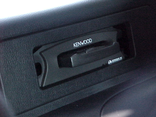

I have derivative of the Phatbox called a Kenwood Keg, in my Nav slot. Works great. I got an Alpine HU with an Aux In ,so no FM Modulator.
