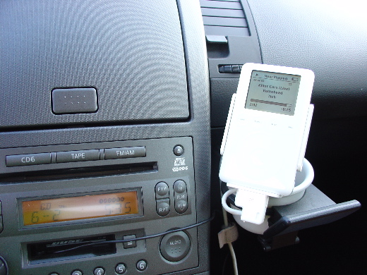

this is my set up.
i used belkin ipod cup holder, ipod ipod auto charger and sony cassette adapter.
easy to use, perfect place to put on ipod.
sound isn't different from listening cds.

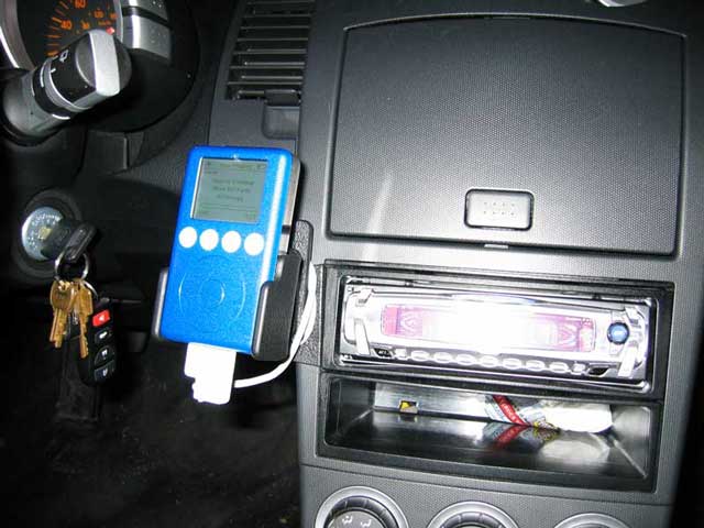

I keep meaning to put up pics of my install.
I went with a mount and clip from ProClip USA (www.proclipusa.com). The mount clips directly to the left of top DIN slot, putting the iPod in a good spot for while you're driving.
I have the benefit of an aftermarket HU, so the next step might not help as much, but I used a Belkin car adapter with the line-out on it, which I wired into a 12v switched source behind my HU (ignition wire I believe), then ran a monster cable splitter from the line-out to the line-in on the back of my HU.
Just a couple of things to note about the ProClip USA stuff. The quality of the parts is pretty good, but the design of the clipping part could use a bit of work. It's designed to clip into the existing seam to the left of the radio, and the othe seam farther back on the driver side of the center console. It clips in well, but there is no vertical support, so if you don't get good contact with the supplied tape strip, it'll slide down and fall off easily. I eventually went with some stronger wall-mounting tape from Home Depot, and I hit the area on the dash where the tape was going to contact with some goof off, which seems to have done the trick.

Here are a couple of pics. Sorry for the quality...

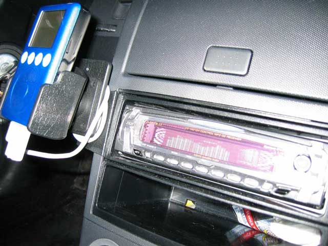

And another pic

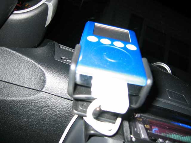

And another. You can see where it clips next to the HU and a little back along the driver side of the center console. You can also see where I got a little goof off on the cover plate from the Metra kit. Be careful here, the dash material is fine, but the plastic from the Metra kit disolves with Goof off.

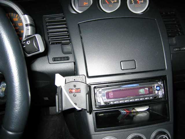

Last one. I also forgot to metion that I got my iPod from ColorWare, so it's painted a color that somwhat closely matches Daytona Blue. It's not exact, but close enough.
