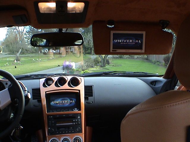

You looking for something like this? Used the stock Nav Monitor with a converter from NAV-TV. Plus added a rear and front camera tied into the stock monitor all controlled by a switch just behind the shifter on the center console in the 'ashtray' like cubby.

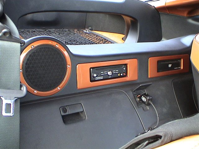

Here's the location for the NAV and DVD players that work in conjunction with the stock 7" monitor. If you continue to run into dead ends on an after market setup if you PM me I can give you the name and number of some one who might be able to help steer you in the right direction.

The original OEM Nav DVD will not play DVD movies with out the addition of a conversion kit. Two do this I needed the following components:
1. NAV-TV allowing FACTORY NAV Screen to play DVD (www.nav-tv.com)
2. AVD300 MP3 DVD Player (www.audiovox.com)
The folks at NAV-TV can direct you to a local distributor who in turn can help you with the install.
My labor & material cost to make the conversion was just over $800.
There may be a better way to accomplish this task but this was the best I could come up with and still maintain all my stock functions.
