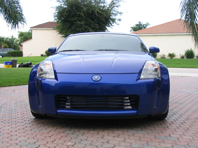

I'm sure you've heard this before... but you have two great looking cars.

Thanks, here is an updated pic of the 350Z
