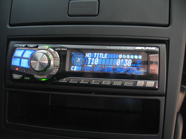

1->Sound quality is great for mp3 CD's and Audio CDs... never tried wma yet... FM quality i would say is average, i used to get better reception in my 2002 altima, probably cause the antenna on the Z isn't all that good i would presume since the stock HU also had bad FM pickup (local LA stations).
2->When i was installing my system, i tried connecting the Alpine without direct connection to the battery and it worked great, but I ultimately decided to connect it since I wasn't putting in another amp.
3->Comes with a neat little case to hold the faceplate too.
4->Get the metra, fits and looks the best. (am attaching a pic)
5->Definitely, anything is better than the stock POS
