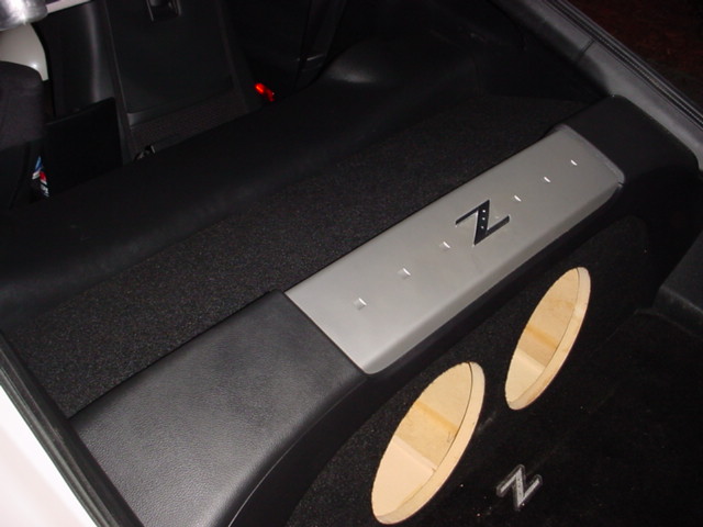

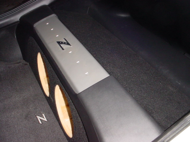

I'm looking around for a new sub box that provides strong bass, good response and good looks. it seems like many of the dual sub enclosures don't have enough air volume for a sub to breathe right. I asked Mike at ZEnclosures about this and he sent me some pics of a new sub box he is coming out with. It has just under .7 cu ft per sub and an amp rack. What do you guys think?

I likes but personally I don't see the need for more than 134 dB worth of bass.

look good but how would you get that in there??

That is a solid design... but are there any air vents?? Can you make it ported?

That's real nice, where can I order that? Fits two 8's?

that would be nice if it were say for a single sub ported.... i don't think .7 per sub is good ported... i don't think he would make a ported box since there are too many variables in different subs.

The box is designed for two 10s. It is not ported, it is a sealed enclosure. I have no idea how it goes in, I assumed it slid in from the back like his other designs, but now that I look at it...? This box was just finished a few days ago and is not up for sale yet. I will post more info as I get it. Thanks for the replies.

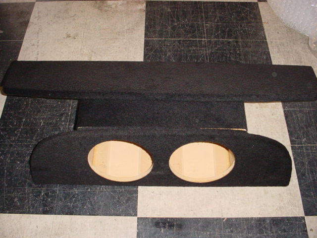

This enclosure just slides in under the strut bar then the amp rack sits on top of the box and gets a few screws...very easy install.
I don't do any porting because so many subs required different lengths, diameters, and locations of the ports.
I will have them for 2-8's, 2-10's, and 1-10. From my calculations the JL 10w7 will fit and most likely any other 10" sub on the market. Airspace is approx. 1.35 cu. ft. for the single ten and .67 per sub for the double.

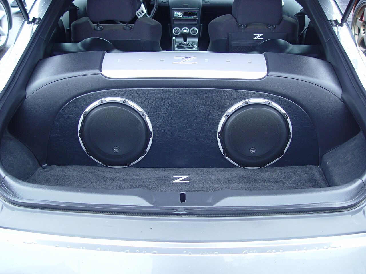

wow, just like the one I have. except mine is fiberglass and covered in vinyl. I have it loaded with 2 10w6v2's and the sound is awesome.
I am sure this will sell big time Mike.

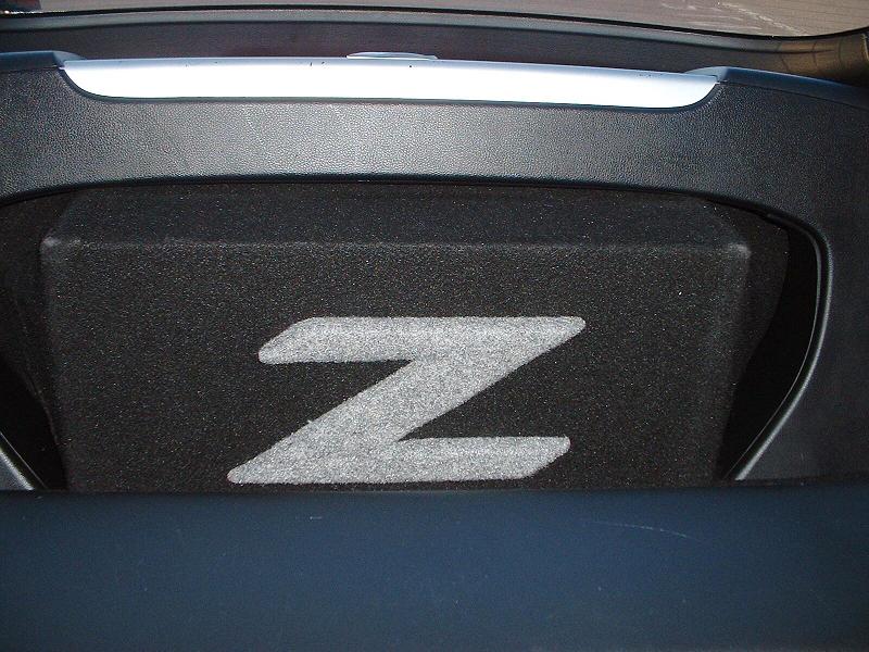

somewhat similar to mine. mine is designed around the specs for 2 10w7s.
