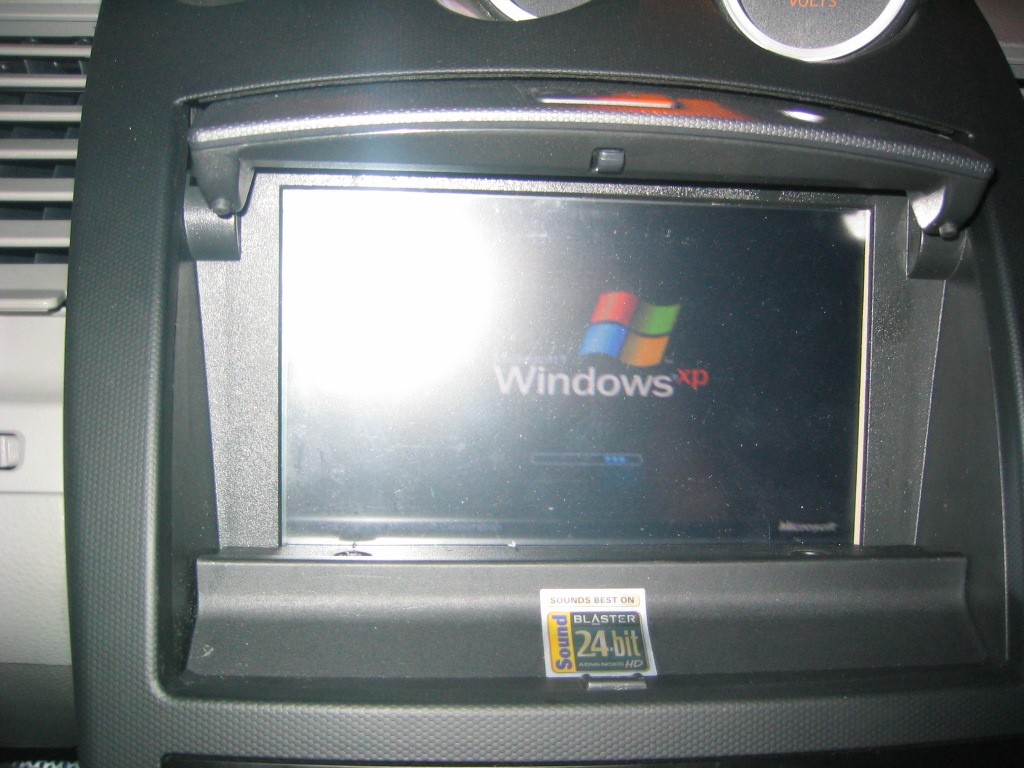

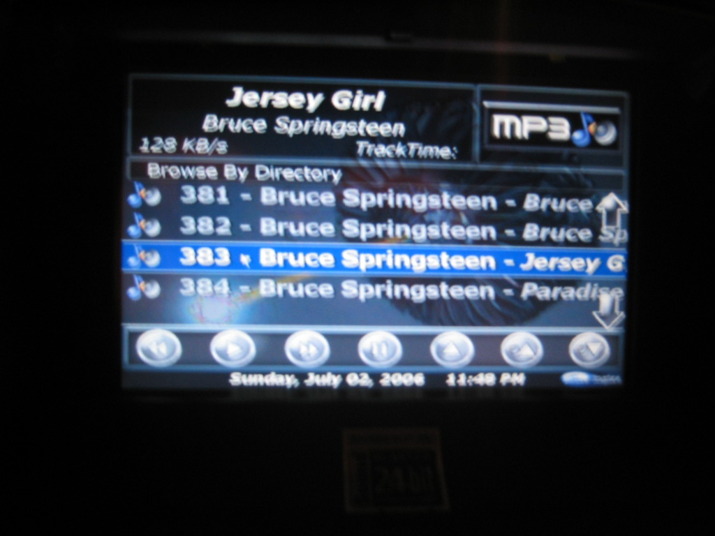

Originally Posted by MERK350Z
hey everyone my car pc is done here are a few pics of what i did
https://my350z.com/forum/attachment....1&d=1151900856
https://my350z.com/forum/attachment....1&d=1151900922
https://my350z.com/forum/attachment....1&d=1151900999
spcs:
IBM laptop x23 p3 900mhz 512 megs 40gigs
lilliput 7 inch touch screen
aux inputs for the system
creative sound card for laptop
802.11b adapter
awesome setup... i have the same setup but using mini computer parts instead of a laptop, the only problem im havin is using the cubby hole that came with the car. Instead i bought the cluster for the nav as they come with the 350z in hopes that the screen fits snug. Any sugguestions? Any help would be greatly appreciated, IM me t Neverdoubtme05 on AIM... thanks

i am using the media engin front end software and i have the option to checked off to start up after windows loads so i dont have to deal with anything once the computer is on
