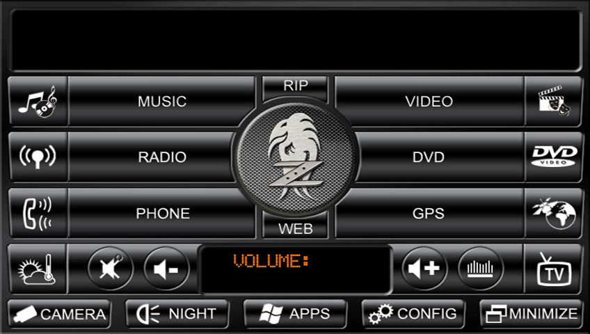

I decided to change the software frontend away from windows media center. I picked up a copy of Roadrunner and found a great skin called BMW e36 which I modded to have my Notion Griffin logo.
Roadrunner really is a great piece of open source software, I'm really liking it and the skin fits pretty well with the rest of the dash, I've attached a screengrab...

RR rocks!
