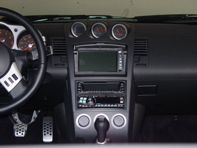

Here are some pics of my install. This is the dash:
Alpine 760 screen
Sony XE-744 EQ
Alpine 7996 DVD/CD/MP3
Total line level specs:
S/N = better 102db
THD = .08% or less
Dynamic range = 95db
Jeff

Looks good man. That Alpine display really fits well.

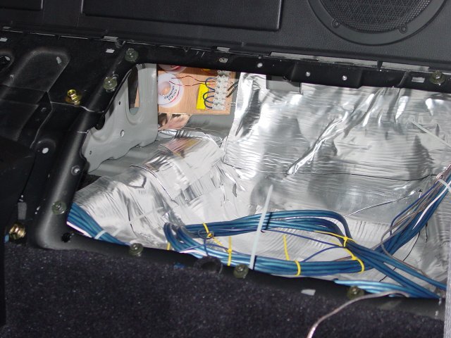

Pic of the sub location and custom designed passive, impedance, and phase compensated crossovers. Also video control module and rear camera hook-up.

19 oz of acoustic fill.

Wider shot of fill. Enclosure is completely sealed. The only air leak area was around the seat belts which now has a custom rubber boot.

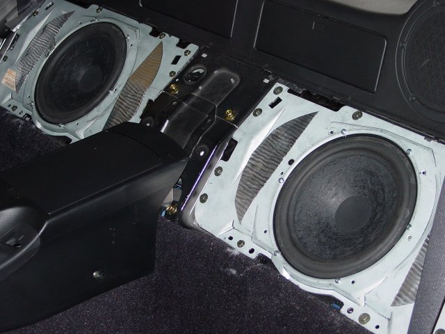

Pic of one 10" Scan Speak 25W/8565 woofer. Sealing and damping the mounting plate.

Two subs installed wired in parralel. Frequency response flat to 33hz. Smooth roll off around 8db per octave placing the 3db down point at 25hz.

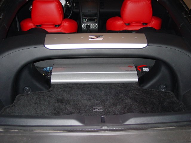

Precision Power amp location.
