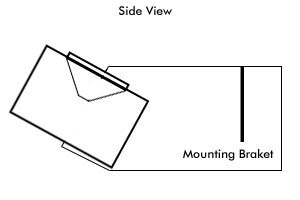

Be careful with that 9" hole. Yes its 9", but the floor flattens out. Since you have to put the box in at an angle, you eventually hit the floor. If the box is not all the way in by then, you are stuck.
In my case, my box ended up being 11" x 16" x 8.5". Add to that the height of the sub itself and you get 8.75". Thank goodness the top of my sub was rubber, because I had to compress it to fit once I hit the floor.
An 11" x 16" x 8" box should give you .5 Cubic foot - maybe a little more if my calculations are correct. That would slide right in.
There is a mounting braket back there. 11" is really spot on, because there is a little valley+dimple towards the opening, and the mounting braket is 11" back. It will wedge in there real nice.
