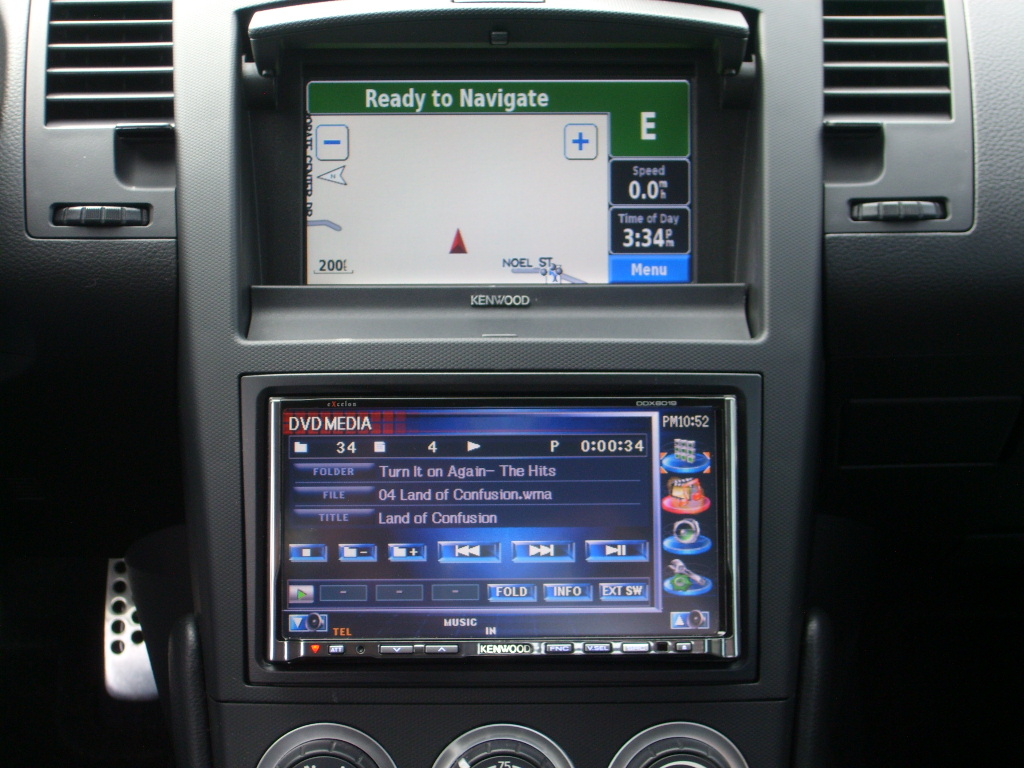

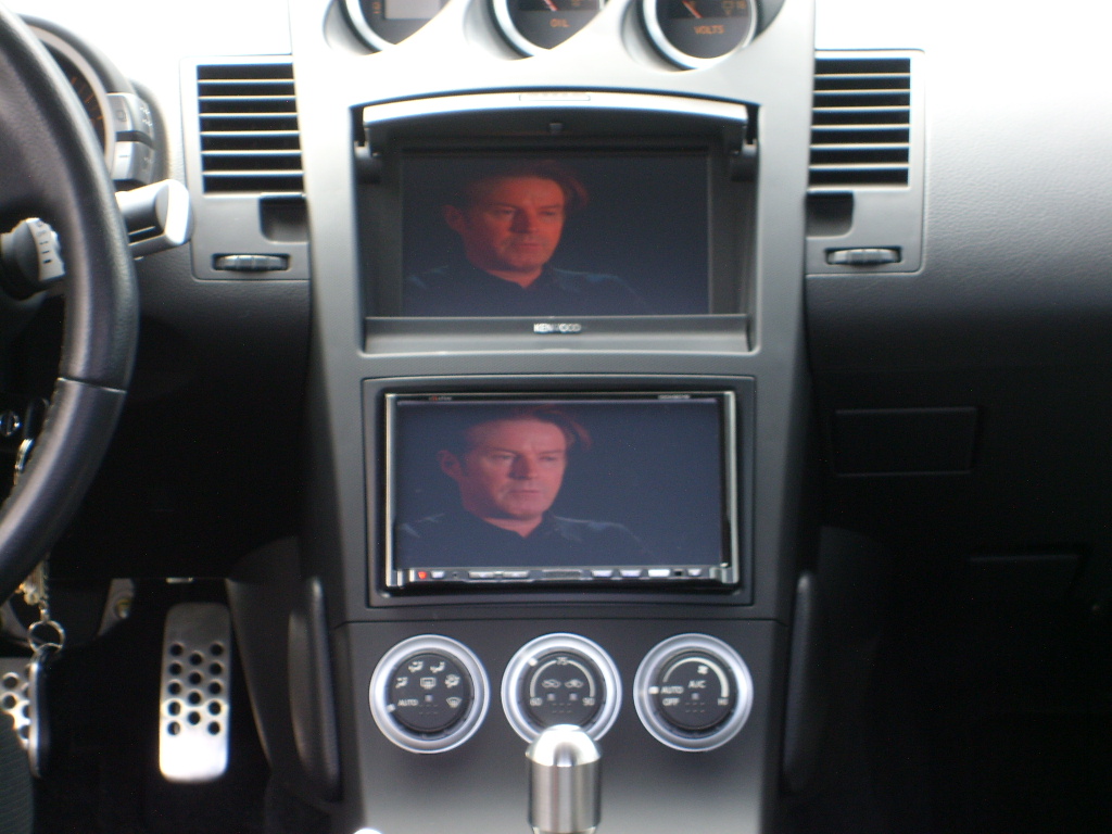

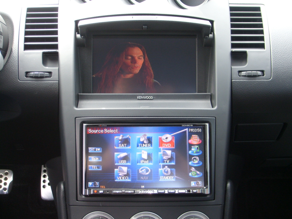

Finally got a chance to install the new Kenwood DDX8019 along with the Kenwood LZ702W 7" touchscreen monitor in the cubby. I also hooked up a Kenwood KNAG510 to the 7" touchscreen in the cubby for Navigaton. As you can see in the pics I can also feed the video from the DDX8019 into the 7" touchscreen in the cubby. I also hooked up one of the external switches of the DDX8019 to pop open the rear hatch from the monitor. I basically touch an icon on the monitor and it pops the rear hatch for me. I also installed the Bluetooth adaptor so I can answer and make calls from the DDX8019 touchscreen.

Duke… That is just a great installation. Finally someone’s installed the Kenwood LZ 702W touch screen monitor in the upper/forward cubby.
Questions:
1. Did installing the LZ 702 require much custom work to get it into the cubby?
2. How do you access the LZ 702 buttons along its lower border. I don’t see any buttons in your pics.
--Spike

You do not need to do any extra custom work to fit into the cubby. It basically is the same size as the opening so it just sits right in.
The buttons are there, they are just underneath the finishing trim piece. I also pondered on this for quite some time and since it is a touchscreen there is really no need to access the buttons except for a few circumstances.
The first one would be volume. Solution I came up with was turn the volume all the way up, since the Navigation has volume on the touchscreen I can controll it through there.
The other would be switching video sources, since I have the video signal from the DDX8019 going into it. This solution is a little more complex, but let me assure you it works very easily and works like a charm.
Other than that you do not need to access the buttons except when setting up the unit, after that you can putthe trim on.

Great install!!! Are you using the internal speaker on the LZ-702W? If so, does the music/sound mute when the nav is speaking?
