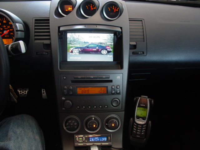

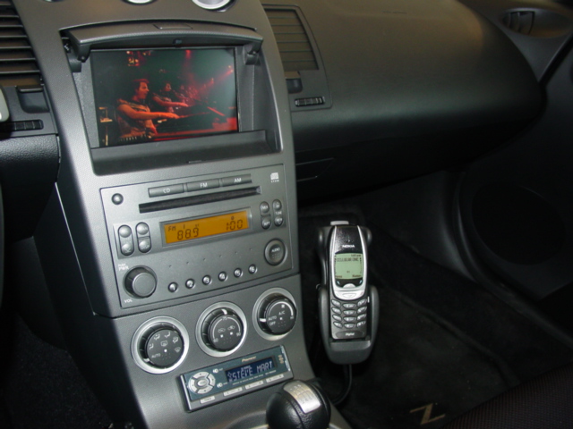

I finally completed the installation of my PC and it is now in the state that I am happy with, with the exception of mounting the tiny toggle switch that turns the power on and off to the FM modulator. I will either put it inside the change box to make it completely stealth, or simply mount it on the side of the console in front of the driver's seat where I can get to it more easily.
Since I have two FM modulators (the other is for my XM radio), I needed two separate radio channels to run both. For anyone who has an FM modulator, you know that when you turn it on, it sort of "scrambles" all of the other radio channels except for the one you must tune to, to run the device. Therefore, I need to turn the power off on the PC FM modulator if I want to listen to the radio. I also have two of my FM presets set to the two channels I am using for my two modulators.
Here are some pics of the FINISHED project:

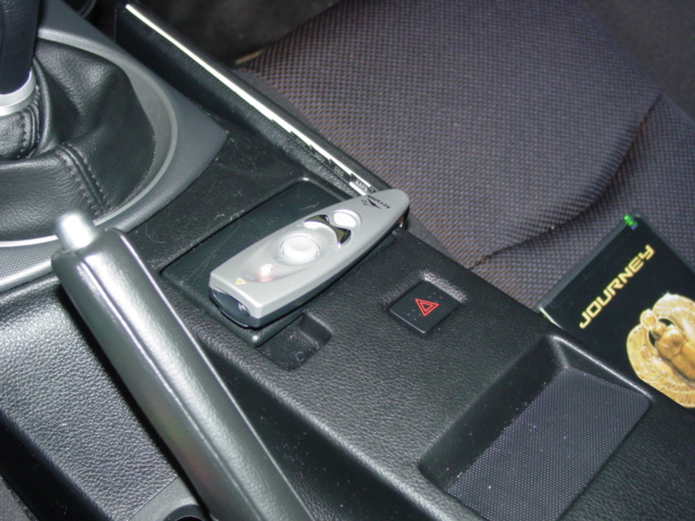

My wireless remote, velcroed to the change box. It is a really convenient place and yes, I can still open the box easily:

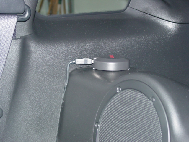

From: Zainoland
This is where I decided to put the GPS Nav. antenna. It is stuck there with double sided tape. My signal is better now too (all green lights). In the pic it looks like it stands out but this is with a flash and zoomed in. You really don't notice it if you aren't looking for it.

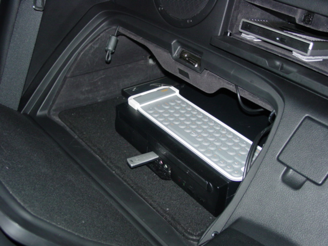

The unit turned forward for easy access in the glovebox.

The sound of the FM modulator is EXCELLENT. Playing a DVD the sound is actually better than the stock radio or CD player. The MP3's and music videos I downloaded from KaZaa are fair. They sound about as good as FM stereo. If you tweak them a bit with Windows Media Player 9.0's WOW effects and equalizer, they sound much better.
Overall, I am EXTREMELY pleased with the entire system!

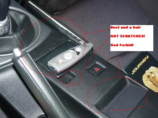

What's up with all the scrathes on the center console though?

Stone: Those aren't scratches:

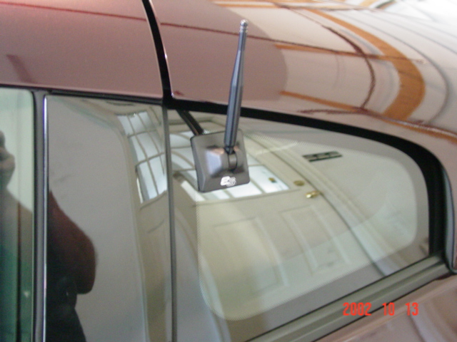

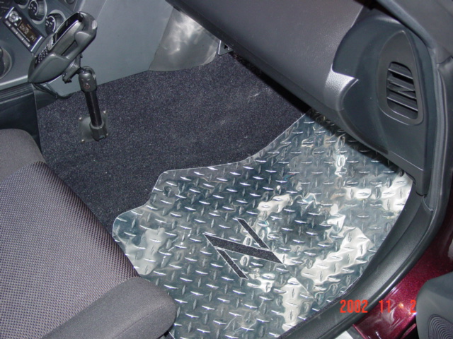

Thanks Raistlin. My cell phone was installed by Cellular One. It sits on a flexible "gooseneck" that is bolted down to the side of the center console. The hands free mic is mounted just left of my sun visor. The antenna is on the small side window on my side.
You can see the pedistal in this pic of my metal mats back in the fall. I stopped using those...too slippery and noisy. Looked unique though...

Antenna:

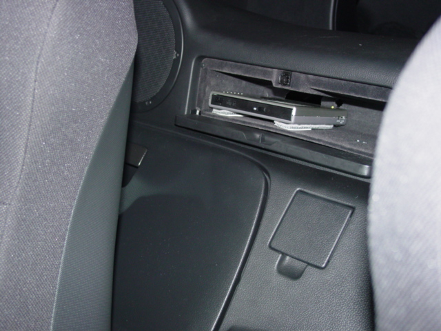

Old Jun 2, 2003 | 08:10 PM
Dr Bonz's Avatar
Dr Bonz
Charter Member #19
Posts: 6,490
From: Zainoland
Alphared: Do you mean under here?
Old Jun 2, 2003 | 10:14 PM
alphared's Avatar
alphared
Posts: 2,504
From: Gehenna
yep. When you take the dash out you can see the two slots on top there. I stuck mines in the one on the right. Its easier to fit on the left cause that big group of wire isn't there that much, but thats where plug for the gauges fits. Ran the wire on the side panels between the center and the driver dash (if you look you see cut outs where you can fit your hand and fish the usb cable up to the top)
Two hints to install it.
1) pop off the ferrite core on the USB B side (where it connects to the antenna) This will make fishing up the panels possible. Can pop back on afterwards.
2) you have to remove the plastic case to fit it in that slot. Its one piece anyway without the case, so I just electrial tape the whole thing to prevent the metal from touching anything in the car. Then connect the cable once it's in place
Its not really hard, have to kinda 'encourage' the antenna in buy pushing back and down the wire bundle thats there. You will need a usb extension to reach the glove box (I think 3 feet should do)
Once thats all done, its really rare to have anyone steal it. With the tape wrapped around it, it looks pretty stock. So unless someone knows about it, it ain't going anywhere.
