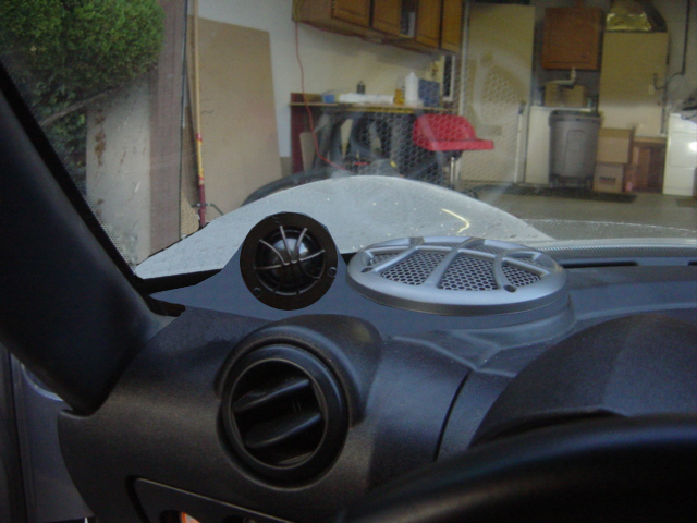

Bing heres an idea for those From Tweeter pods and 5.25"
Make a pod that mounts flush in the area of the oem speaker then build the tweeter pod in the corner. I attached a picture to help picture it. My photoshoping isnt the best.
thats about what i had in mind...
except one part, if you look at how close the grille comes to the windshield at the front corners, it relaly cannot be raised at all anymore, anymore would mean you have to face hte spekaer into the windshiled to get it to fit.
my plan is however, to mold a tweeter pod not unlike what oyu drew...though it hink ti make it look right, it robably cant be that much on axis, cause the dls tweeter is kinda big bahind there...having a little hump would make it look less integrated then if its more of a gental flowing rising mold...
but the customer didnt seem to mind the mounting, so we will see...
