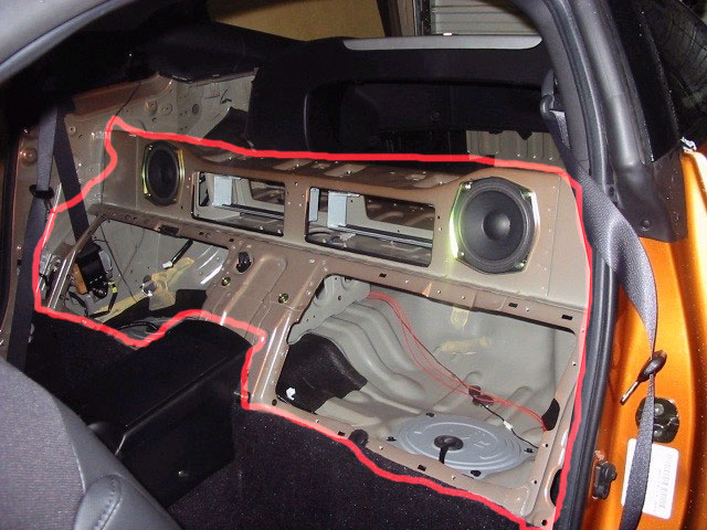

Do I need the metal frame that i circled in red? Does all this metal add rigidity to the car? I am thinking about ripping all of it out!
Add a 4 pt roll cage and install the audio! But if i dont need the roll cage, even better!
All that metal taking up space seems like a waste for 2 crappy 6.5 speakers

hmmm im gonna have a stab at this since its a very interesting thought. Firstly i think all that metal is there not only for speakers, but also for all the storage compartments, which also contribute 99% to the Z's total storage space. Also its a parcel shelf, all cars have them and i really cant imagine what the car would look like without it, from factory that is. Thats me defending that huge plastic covered metal thing.
Now, i really doubt it forms any structural part of the car, the steel isnt reinforced, the opening is hollow, and if it were a vital part of the car, it wouldnt have all those storage gaps over the majority of it. Also the rear strut brace looks to b the main rigidity foible.
btw, u should b able to work it out by looking at how the parcel shelf is attached to the chassis of the car. If its all heavy duty riveted/bolted, then ud assume its a necessity.

that was my thinking as well. I am gonna start putting together this audio project.

Wrong big time on the structural comment. Nissan would not have all that expensive stamped sheetmetal and welding for no reason. Partly its there for the convertible, but it also adds a lot of rigidity to the coupe. If you want your car to handle and ride like a GM or Ford sports car then go ahead and remove it.

um, i did mention a 4 point roll cage.

I'd bet it does add some stiffness to the body since it is a unibody designed car, but probably not much. If you replaced it with a small cage you'd be fine I'm sure. Like ZEXC-33 said though, I'd look closely examine the welds to find out the real purpose. If they're just small spot welds, it can't be doing much good.

Jesus man. I felt bad enough cutting 2 4in holes behind the brace for my ports. Youve got bigger ***** than me. I would saw a customers car in half, and not blink, but on my own car I hate even making screw holes. How is the G35 set up? Is the brace your speaking of even there? Also I remember seeing a post of a full race 350z. It still had the brace behind the seat, even though other seem to be important parts were removed. It also had a roll cage. I dont know what to tell you, but good luck.

Don't make a big deal about the alpine 1 civic. I cannot do my original planned install. I asked a trusted friend who owns a collision shop and he saw the cross brace. He said it is very important and you cannot remove it without replacing it with something. He did say I could open the space up with something as simple as welding some cross braces that take up less space. But I will save that for some other time.
