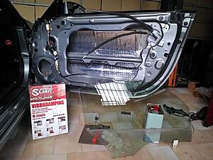

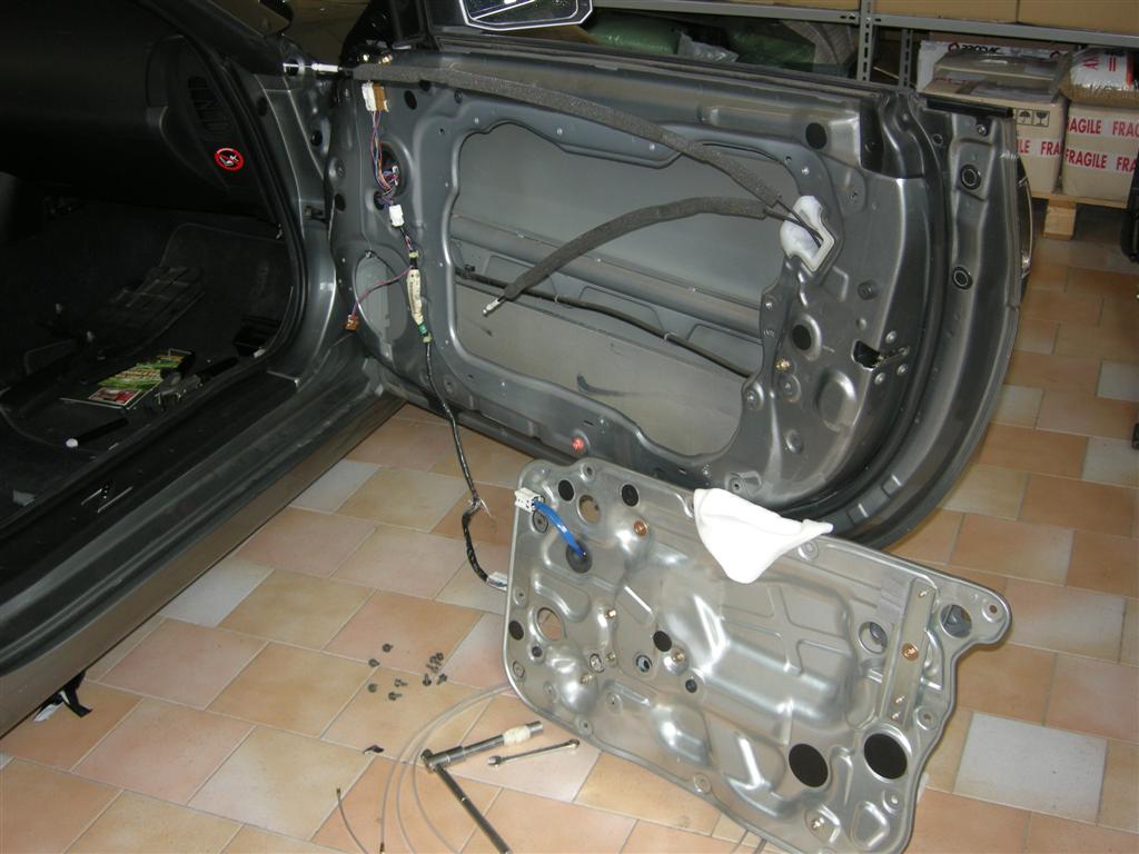

It begins with the disassembly of the interior
And with the disassembly of the doors

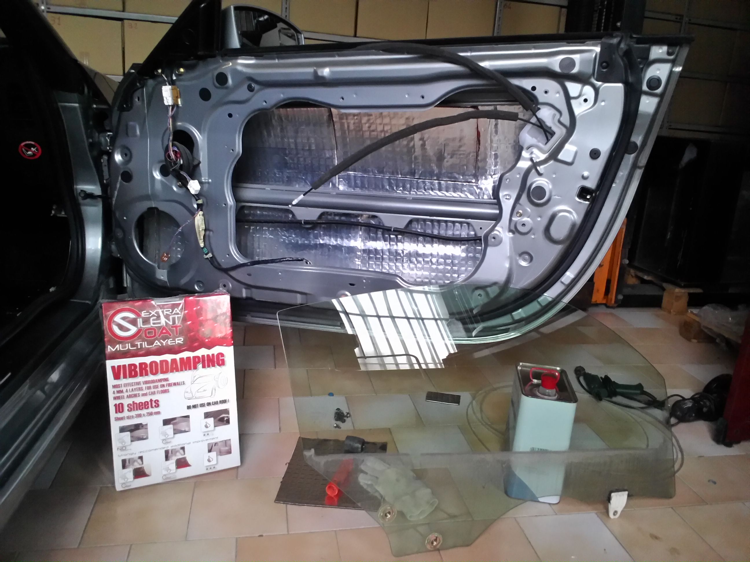

Sound insulation

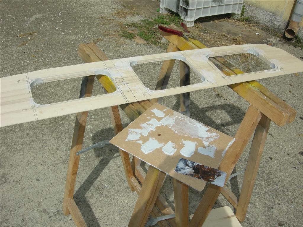

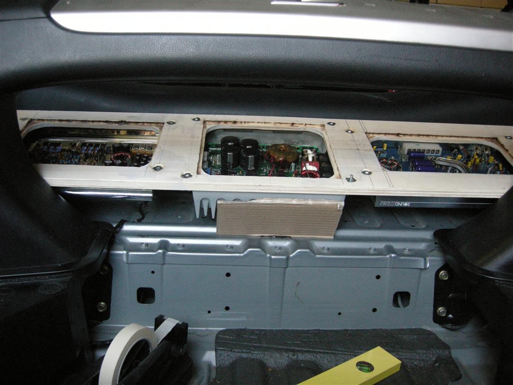

I begin to study the racks for amplifiers: Soundstream D200II to medium-high, Precision Power PC2300 for the woofers, Rockford Fosgate BD1000 for SUB. Only American old style
We decide to fit them with electronic view
We're almost there

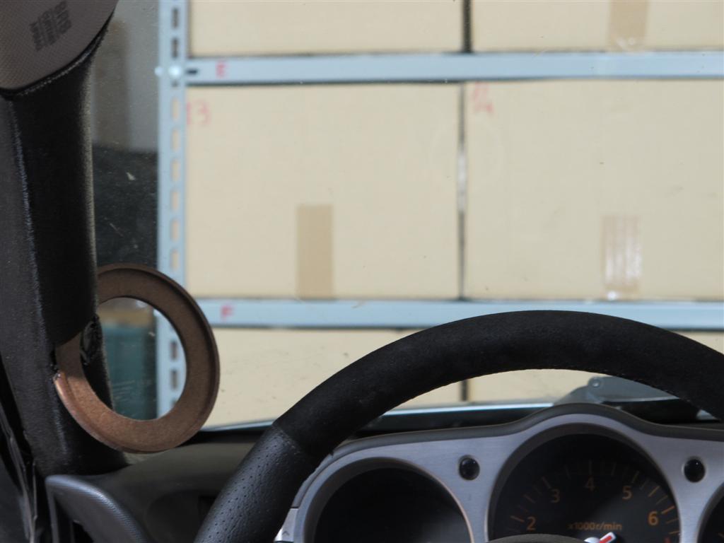

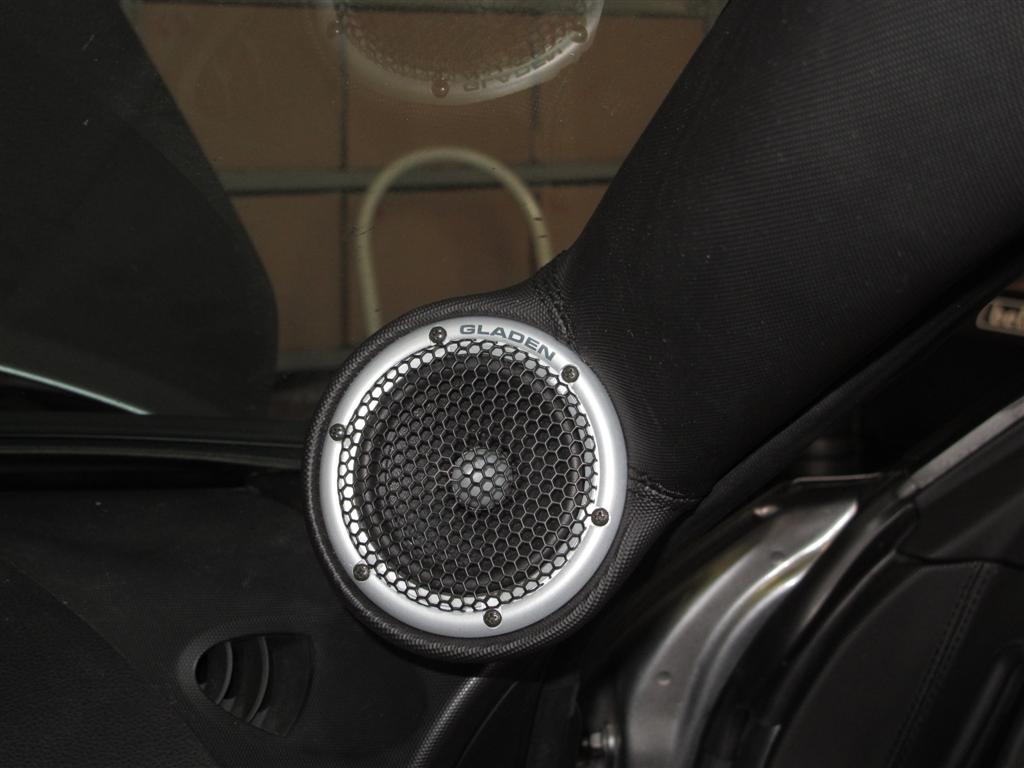

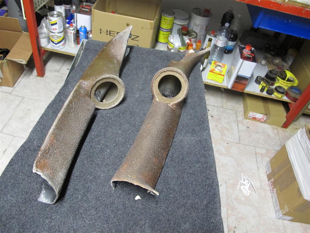

This will install a front facing three-way

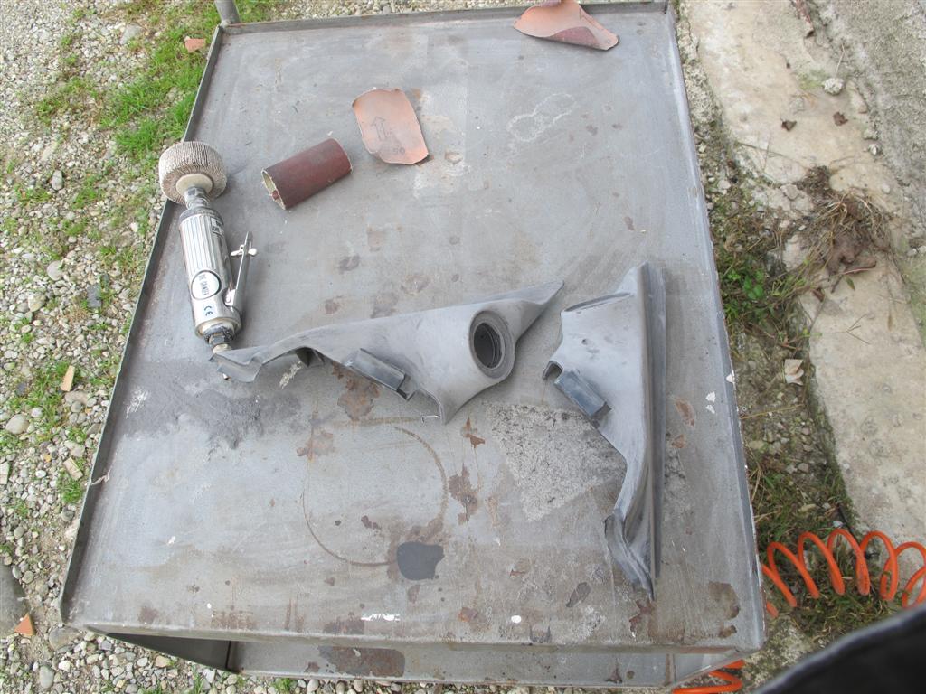

We start preparing the house the midrange
And it goes to the housing of the tweeter

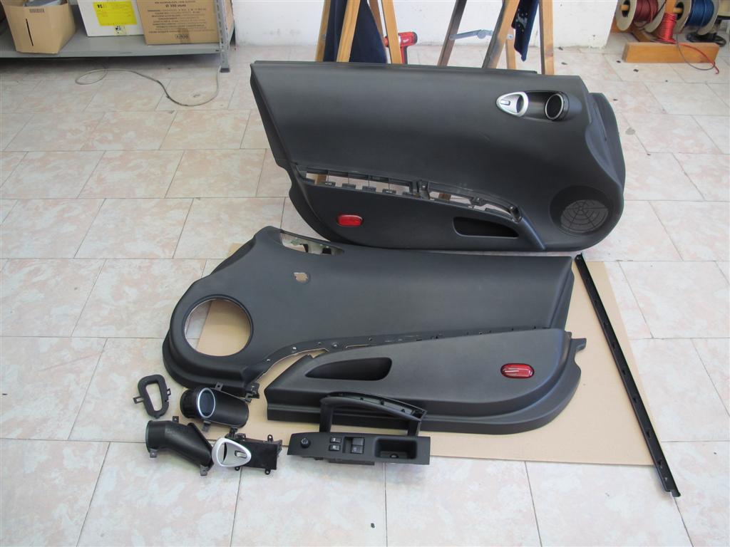

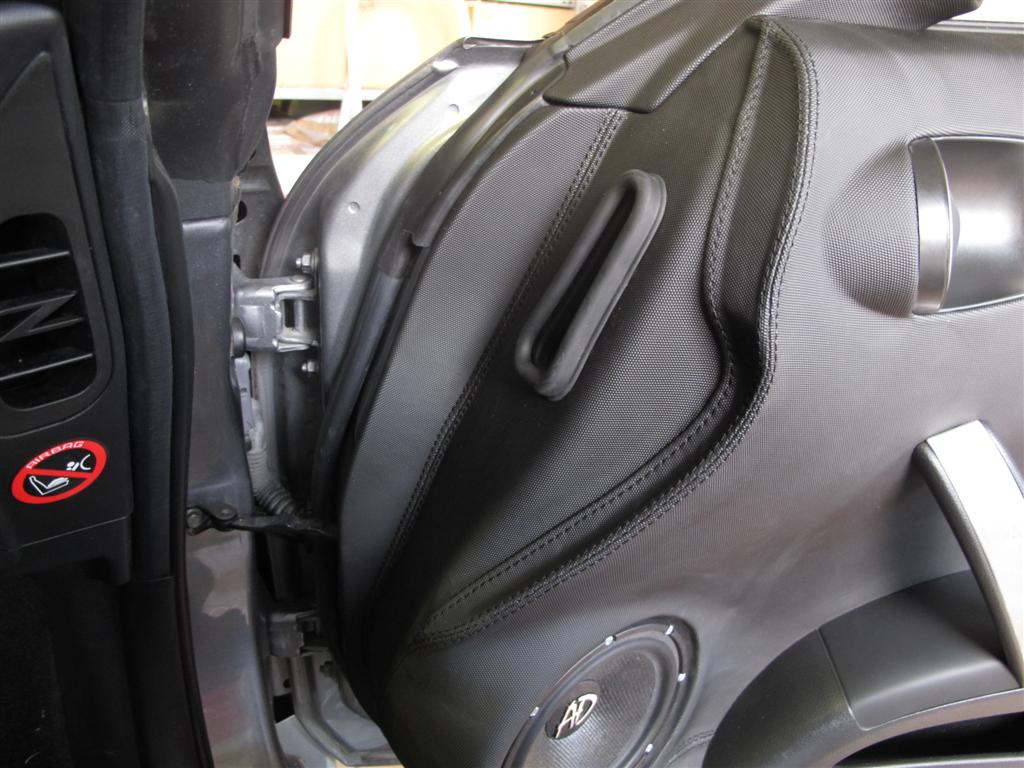

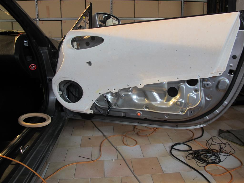

The biggest job is working the door to welcome and orient the 16cm woofer
The average-high is complete

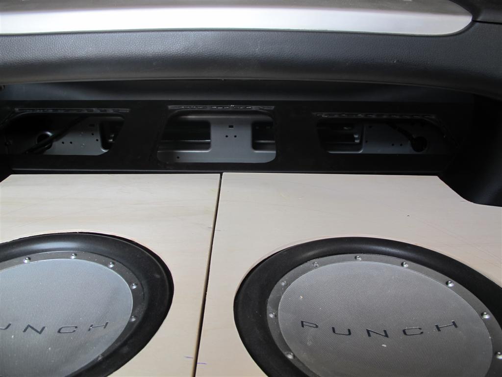

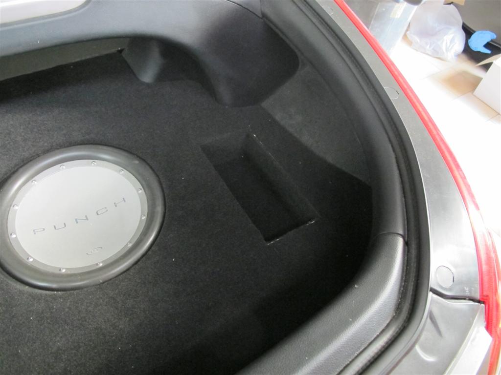

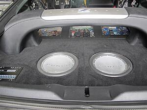

After much deliberation it was decided to sacrifice the spare tire to accommodate both 30cm subwoofer that I had available (Rockford Forgate P3)
In the last picture you can see the housing of passive crossover between tweeter and midrange. The rest of the system will be actively controlled by a DSP Audison BIT TEN

What vinyl did you use on the doors and how did it match?
Old Nov 11, 2014 | 10:31 PM
marcoferrario's Avatar
marcoferrario
Joined: Feb 2013
Posts: 9
From: ITALY
Simply BOSTIK (is so called in USA ?)
First be roughened
I did not understand the question

i think that he is wanting to know how it looked compared to the parts that were still factory
Old Nov 20, 2014 | 09:15 AM
marcoferrario
Joined: Feb 2013
Posts: 9
From: ITALY
The skin is almost identical to the original . To the touch , however, is more enjoyable
