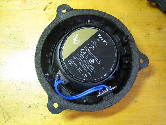

I'll keep an update of the sound system upgrade on my Z in this thread. It is a 2005 Enthusiast Coupe with a manual transmission and the base audio system. My planned upgrades include the headunit, front and rear speakers and addition of an amplifier(s) and subwoofer. I have a JL audio stealthbox for the subs, and plan to install 2 10" Infinity Kappa's. I had previously changed the radio over for a basic Pioneer bluetooth DDIN one I had on-hand - though this will be further upgraded at a later date.

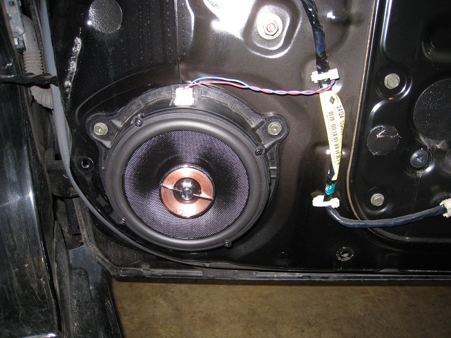

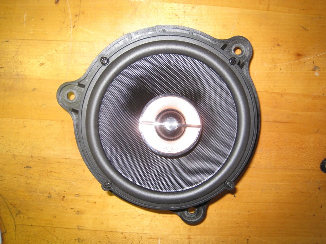

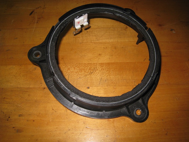

Today I installed the new front speakers. I used Infinity Kappa 62ix speakers, and mounted them in modified base speaker cradles. By that, I mean I cut out the base speaker cones and shaped the mount to accept the 62ix speaker. I also re-used the base speaker's connector, so that the OEM connection could be retained. I had first tried fitting some Infinity Perfect 600 components, but the woofer sits too deep into the door and I didn't want to modify the door panel to make them fit. I may still use them for the rear speakers, or I may save them for another project.

The speakers fit behind the door panel and stock speaker grilles without any clearance issues. They also don't interfere the window glass travel.

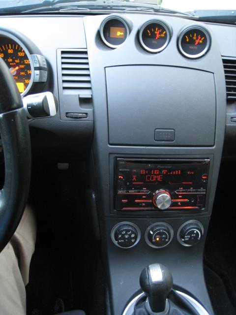

This is the radio that I am using, for now (previously installed):
