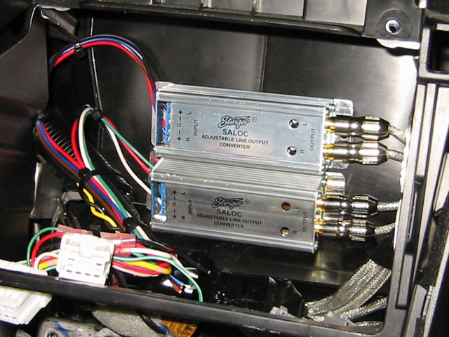

Originally posted by hosss
how did the guys tap off your HU? You said with RCA jacks.... is that all? Apparently no problem with sound quality according to your post. any info would be greatly appreciated....
Actually, they wound up having to use line converters. I forgot to question him about what the reason was, but they tapped into the high-level outs and then just stuck them thru the converters.
Sound is good, the only thing I've noticed is there is background hiss at the start of tracks. However, to be honest this could just be the speakers recreating the tape hiss from the recordings, as it varies in loudness from CD to CD. I'm going to listen to it for a few months and then decide if I need to replace the HU (but really like the stock look)....
Here are the line converters, installed behind the HU:

Old Oct 29, 2002 | 09:20 PM
  #39
nizl's Avatar
nizl
Posts: 623
From: siphonband.com
Originally posted by MSGarrett1
Hey Nizl . . . could you please post the manufacturer and color name for the vinyl that was used in your install so that we may benefit from the research time/expertise of your installers? Thank you in advance. Sweet install. Excellent taste in components. It must absolutely rock!
Ooooo - good question! I will have to follow up on this. I'll ask him and get back to you. In direct sunlight it's slightly too light. In normal light it's a really good match. So, you may want to go a shade darker. The texture is great, though.
