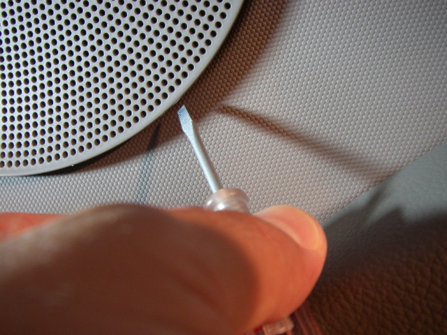

I finally completed the mod myself. It was extremely easy, only taking a bit of patients. Here's a couple of shots of the material I ordered. Only $6.95 for a nice roll. Probably enough to wrap 6 grills.

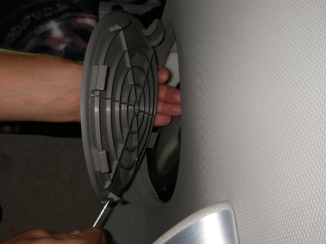

I also included some photos while I was removing the grill. It was extremely easy, while prying opposite the large tabs. No indentions were made on the side panels either.
Attached Thumbnails Write-up: My solution to the stock sound-blocking door speaker grills-imgp2206.jpg   Write-up: My solution to the stock sound-blocking door speaker grills-imgp2207.jpg   Write-up: My solution to the stock sound-blocking door speaker grills-imgp2208.jpg   Write-up: My solution to the stock sound-blocking door speaker grills-imgp2209.jpg   Write-up: My solution to the stock sound-blocking door speaker grills-imgp2205.jpg

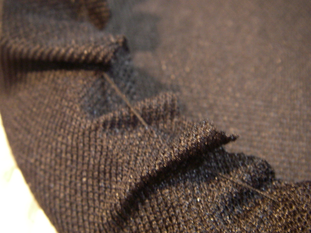

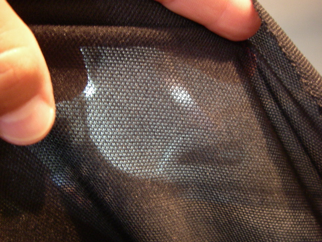

Next was the cutting, cut out, and wrapping. I used the sewing method.
Attached Thumbnails Write-up: My solution to the stock sound-blocking door speaker grills-imgp2212.jpg   Write-up: My solution to the stock sound-blocking door speaker grills-imgp2213.jpg   Write-up: My solution to the stock sound-blocking door speaker grills-imgp2214.jpg   Write-up: My solution to the stock sound-blocking door speaker grills-imgp2215.jpg

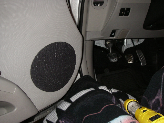

And finally, the end product..
Attached Thumbnails Write-up: My solution to the stock sound-blocking door speaker grills-imgp2216.jpg   Write-up: My solution to the stock sound-blocking door speaker grills-imgp2217.jpg

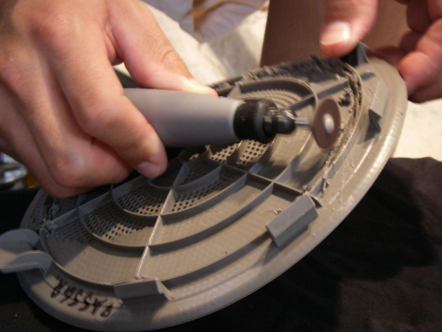

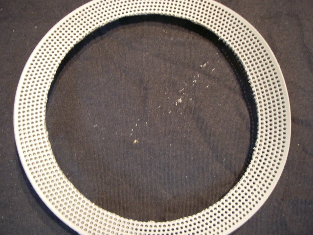

Awesome write up guys~ So I thought I'd give it a try. Turned out great!
First, I went to the fabric store and bought some black sheer, non-stretchy fabric ($3.50).
Then I popped the grills out.
Then I dremeled the obstructive center piece out.
Attached Thumbnails Write-up: My solution to the stock sound-blocking door speaker grills-dsc01978.jpg   Write-up: My solution to the stock sound-blocking door speaker grills-dsc01979.jpg

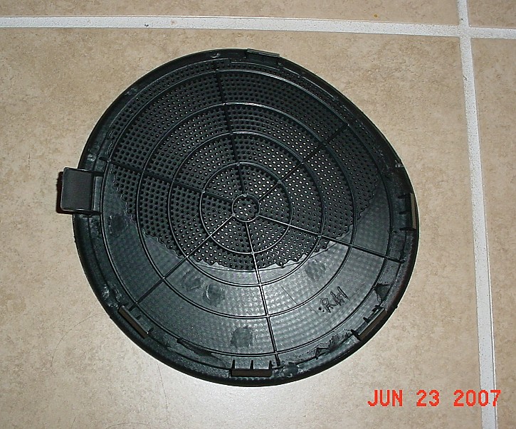

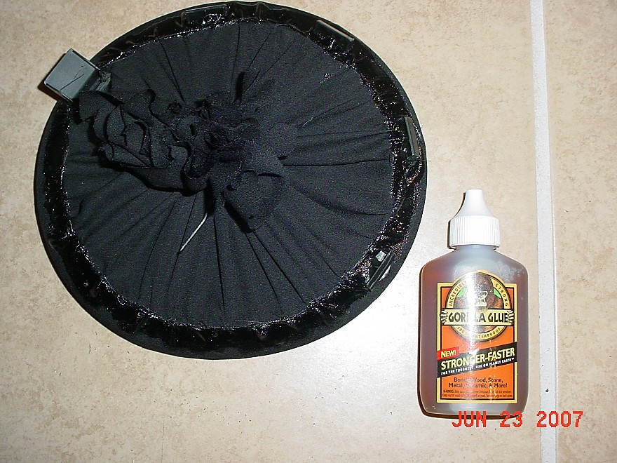

Stretched the fabric over the frame.
Secured it with a ziptie.
Sewed (cinched the edges tight).
Put a thin layer of Gorrilla Glue to hold it all.
Let it cure over night.
Attached Thumbnails Write-up: My solution to the stock sound-blocking door speaker grills-dsc01980.jpg   Write-up: My solution to the stock sound-blocking door speaker grills-dsc01981.jpg

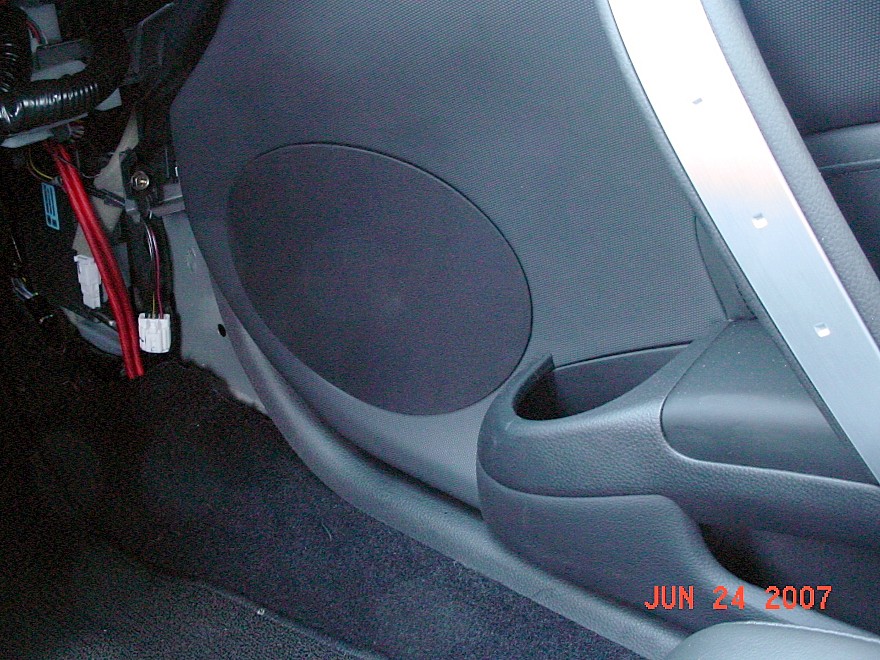

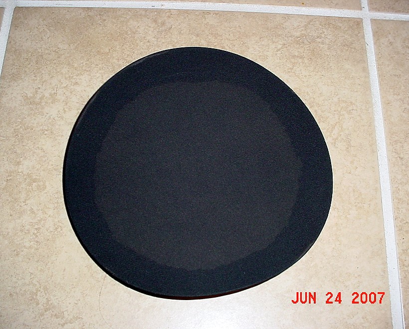

Cut the zip tied back section out.
Installed them back into the car doors.
Viola -
Looks very professional. And the sound quality is night & day better than the TARD oem grills. :-)
Attached Thumbnails Write-up: My solution to the stock sound-blocking door speaker grills-dsc01984.jpg   Write-up: My solution to the stock sound-blocking door speaker grills-dsc01986.jpg

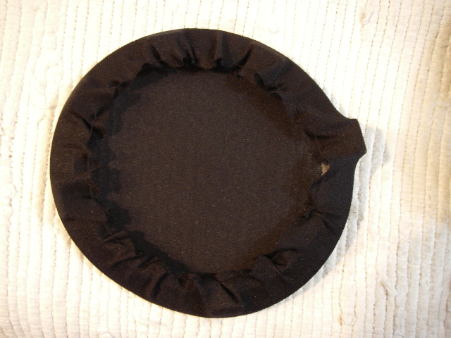

Old Jul 14, 2007 | 09:01 AM
