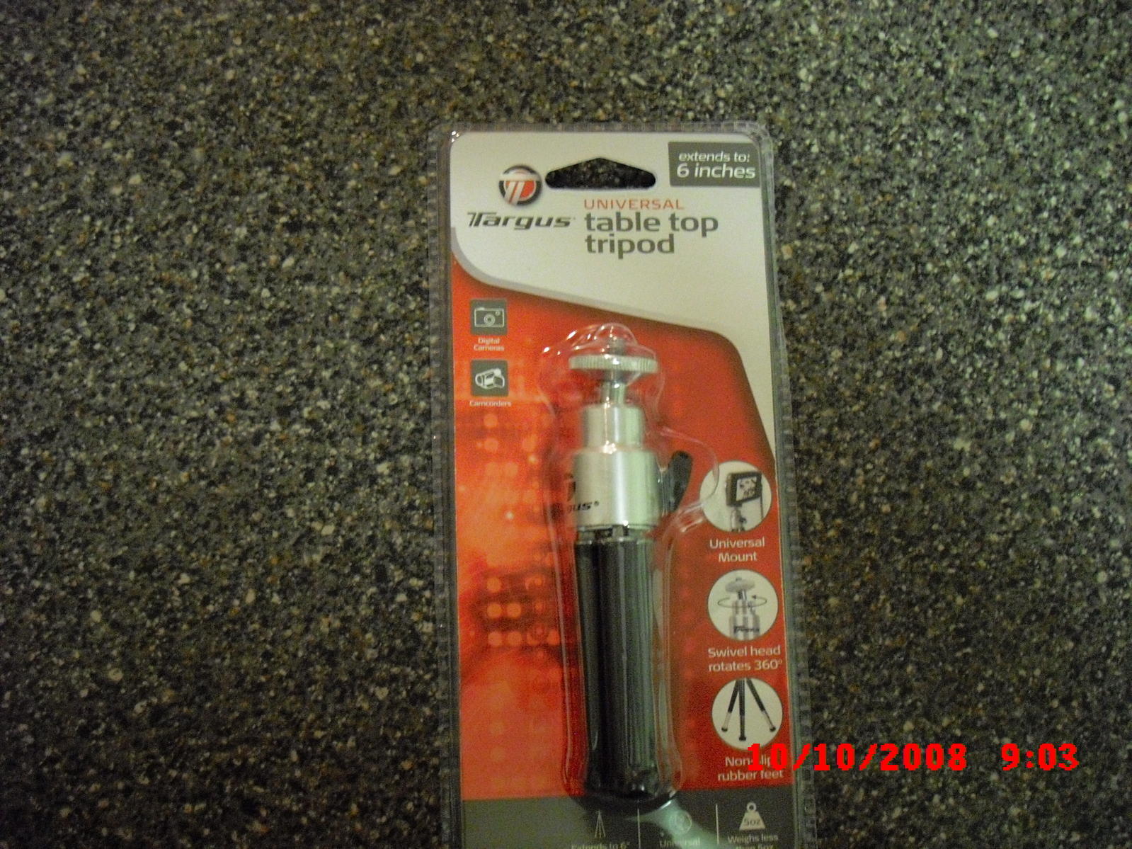

Default Update: Aluminum camera mount
UPDATE:
Hi,
while at a local TARGET i found this TARGA Universal Table Top Tripod camera mount. COST $6.99
It's pretty much an identical copy of the plastic "Dollar General" one used before but this one is much better of course. its made from machined aluminum and has some nice weight to it. the upper cylinder moves 360 degrees where the ball/arm does tilt........
You disassemble the mount the exact same way. There is a philips head screw at the base...
the legs come falling out and then these two disc are left.
In-between the disc is a small rubber o-ring. Which maybe good to keep for reinstalling the longer screw needed for the DIY. I don't know the thread pitch yet, but ill update that once i do.
UPDATE:
The bolt i used was an M4x0.7 pitch 30mm long - bought at home depot in their hardware section, pull out drawers.
-J
