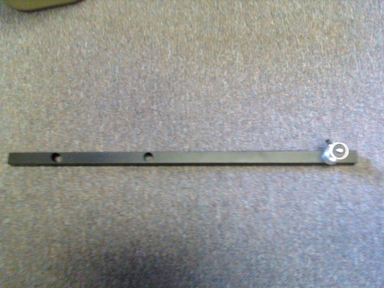

I made my own, but instead of painting it with a normal paint, I used a rubberized spray paint from Home Depot. I like the rubberized paint so I don't have to worry about scratching up the head rests.
I still need to find end-caps for my mount, but once I have them I will attach them.
Anyways on to the pics.

Originally Posted by Goofy1477
Great DIY.
Thanks!
hey, see post #7 - but i got the end caps from here: http://www.stoveparts.net/Merchant2/...Code=GLD-01086
call instead of order online and he will give you a total with shipping over the phone, i paid 3 bucks i think for a bunch shipped. they fit perfect.
