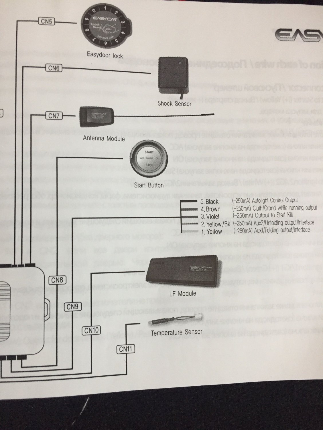

I just bought easycar E8-B the model is M7700C
My car is mercedes benz w140 s320 1997 first
i wired CN1 all wires CN2 only the ground black wire
CN3 i wired
CN3-1 to the unlock
CN3-2 the lock
CN3-3 to the signal light
CN3-4not wired
CN4-5not wired
CN3-6 wired the the siren
CN3-7 not wired
CN3-8.not wired
CN3-9 not wired
CN3-10 wired ground
i took of my ignition i left the key near the transponder
foe the CN4 first it's defferent from M7700B
CN4-1 Alternater Sensing
CN4-2Break light
CN4-3 Break light
CN4-4not wired
CN4-5 to the Parking break
CN4-6 to the door trigger
CN4-7 not wired
CN4-8 not wired
CN4-9 not wired
i cut the jumber
I have wired the CN5 and the CN6 ,CN7 ,CN8 and the CN9
Cn9-1 not wired
CN9-2 not eired
CN9-3 wired to that place ok
i finished wiring i programmed the knock sensore it works great i had programmed the two remots and it works i tried to star the car from the push button the Acc worked at first push in the second push al the car functions worked great i pressed the feet break and pressed the start button it flash one time and cut the power ffom the dashboard twice and didn't start i tried by the remote it did the same all the function works by remote accept remote start i tried to inter the car by the knock sensore it also works
please help me if you solution for my peoblem

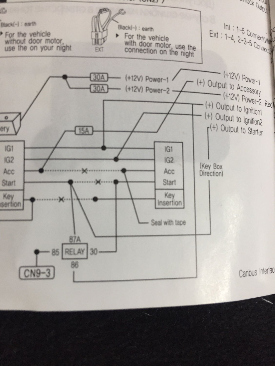

I know this is an old thread but I kind of need some help as well so if anyone is still around I will really appreciate it.
My problem is with a Mercedes ML320. I believe it has to do with the fact these models have an ACC cable tied to/working with the ignition (or maybe I just wired it wrong). Basically, the ACC wire tests 12V @ACC @ON and @CRANK. A pure ACC shouldn't have voltage during crank, only @ACC & @ON. So the push start sequence goes from ACC to ON/Start taking only 2 clicks as opposed to the normal 3 (ACC then ON and then Crank). Also this happens regardless of the brake pedal being pushed or not, the vehicle starts anyway. The brake pedal is then needed to stop it as it should be.
The wiring coming out of my ignition switch are:
Ignition1 going to CN1green - The side exiting from the relay
Starter (wire cut) going to CN1 yellow on engine side + green/white from the relay ****
ACC going to CN1 Blue
Power going to CN1 red/red-white
Keysense going to CN3 Grey
**** This is where I'm unclear about the connection since I'm missing a green wire compared to BeeBoo diagram. Also, on my relay, the green and green-white wires are jumped together by a small piece of wire.....Why?
To clarify, my wiring is following BeeBoo diagram (besides he has 2 green wires coming out of the relay, one going to Ignition1 and the other to the Starter along with the yellow wire from CN1, while I only have 1 green & 1 green/white and a jumper between them 2. So there's is only 3 total wires coming out of my relay (green/green-white/purple) as opposed to 4 shown in his diagram)****
Confusing I know
But that's why I need help and hope there's still some kind souls around here willing to provide it.
