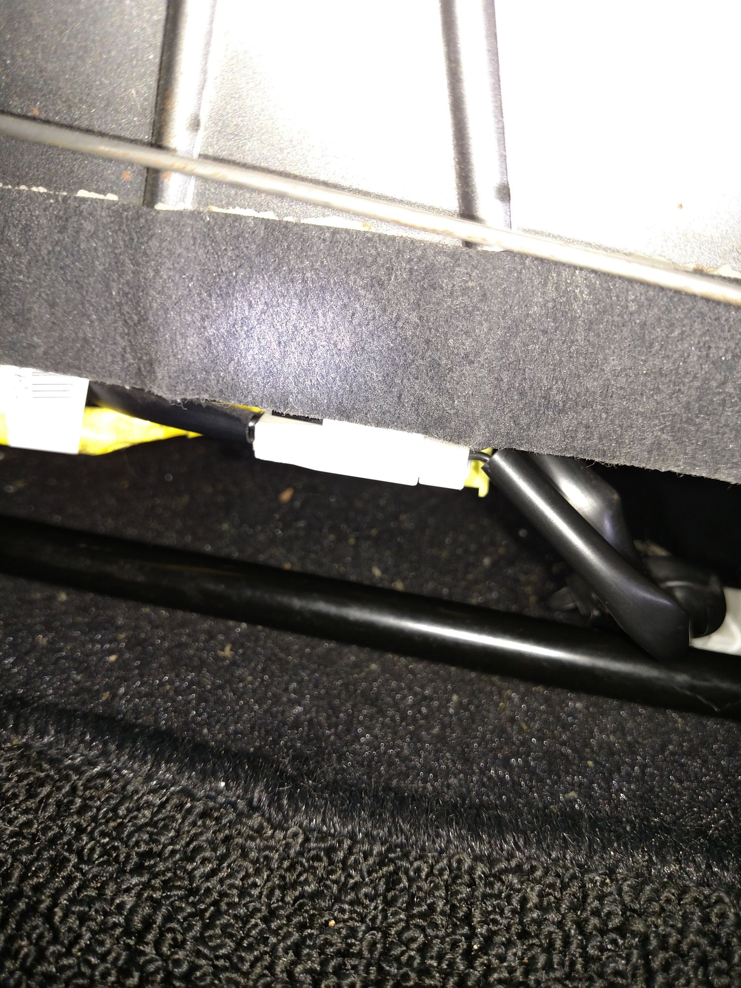

I bought a 2008 350Z this past September and since owning it I have been slowly making my way down the list of minor repairs. One that I don't particularly feel is detrimental, but I would like operational is the seatbelt light. I can't quite pinpoint if it's just the driver's or passenger's side or maybe both. However, both seats have this 4 pin connector that is just hanging there. Does anyone have any clue where they are supposed to be plugged in or am I just barking up the wrong tree... Maybe lost in an entirely different forest?

OK. From the pictures in your original post, the 4-pin connectors looks like it has female pins, making it the car-side connector. Since your seats are neither powered or heated, there are no seat connectors to complete the circuits.
If your seatbelt latch was disconnected your seatbelt light would never come on, so I suspect the problem is in the latch itself. I recommend you get a copy of the Service Manual for your car. You can download one from this web site:

Traced the seatbelt latch to this whitr connector. It was connected... Sad results there. Any other suggestions before I just ask my technician?

As I said in my last post, it looks like the latch itself is faulty. The Service Manual includes troubleshooting procedures. Even if you don't find the fault, you might be able to eliminate some possibilities, making the technicians job easier and cheaper.
A quick check would be to disconnect the seatbelt connector, connect the two pins on the car harness side together, and see if your seatbelt light goes out. That points to the latch being at fault. If the light doesn't go out, then you have a problem with the wiring.
