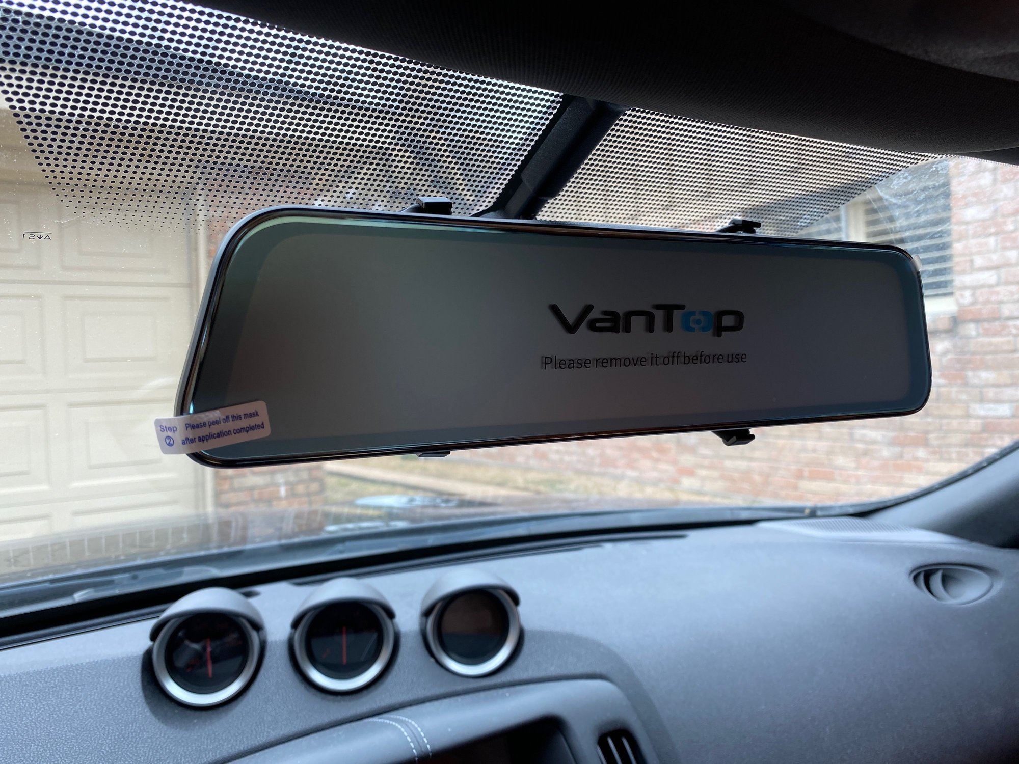

The mirror arrived early today. First step - fitting.
The straps work well. They firmly secure the mirror in place over the old mirror. I expected not to like the esthetic, but the look is not as bad as I thought it would be. It covers the original mirror for the most part and the hooks are unobtrusive.
VanTop Mirror in 2016 Nissan 370Z

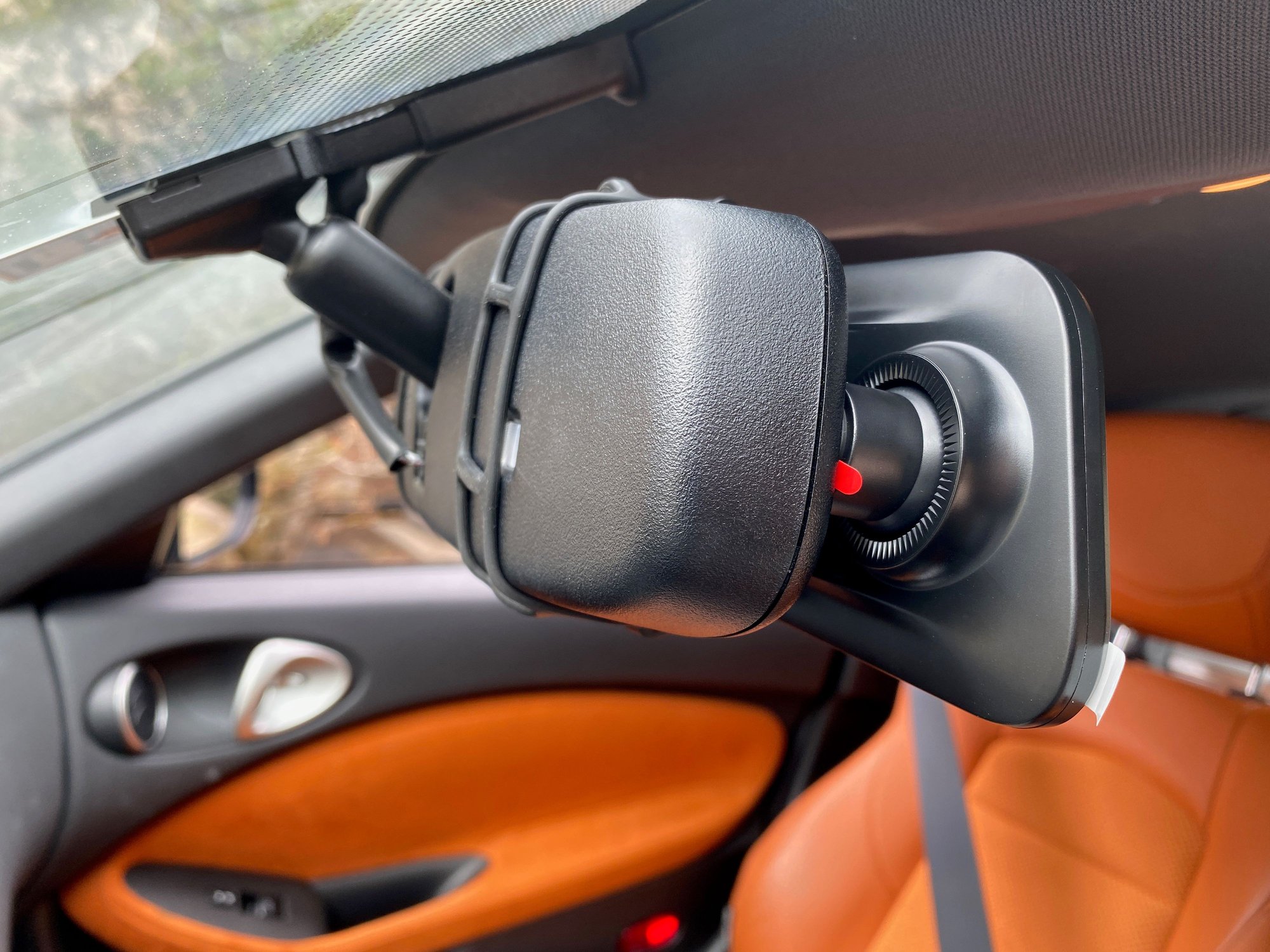

The problem is that, when centered, the original mirror blocks the forward camera.
Original mirror block the camera view.
A quick solution is to slide the new mirror off center to the left. This is a temporary fix. I have ordered a replacement mirror back plate. I should be able to adapt the plate if it gets in the way of the cam. It will take a month to arrive (!) but I can live with this solution until then.
Next steps. Wire up temporary to the cig lighter and live with it for a few days to make sure I like it before rigging permanent cables.

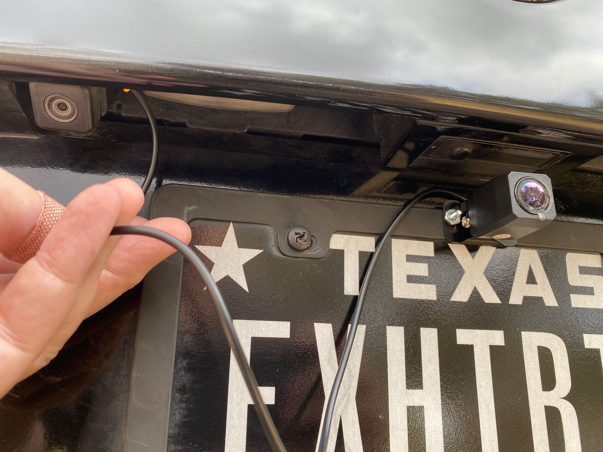

Right now, I'm attaching the new wide-angle cam to the back. Looks like there is a space beside the factory cam to take the wire into the bumper. From there, The interior of the bumper is unexplored territory for me. If I can get the wire into the car I'm sure I can find the route to take. Just not sure how to get it into the car.
Are there any diagrams or drawings that show what's behind there, and what I might need to remove to get there?
Wide-angle camera mounted on metal license plate frame
