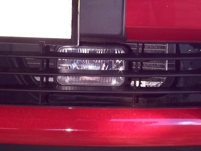

No matter what I tried ( HID ) low beam just didn't seem acceptable - fitted a pair of "extra" low beam lamps in behind the grill and am much happier with the result. Extra lamps are legal in Victoria ( as long as they are type approved and don't dazzle oncomming drivers ). Will post some photo's and details if anyones interested.

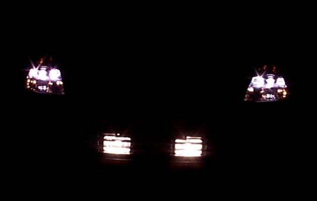

The digital camera is an old one and insisted that it use the flash - so contrast is a "bit" poor however.....

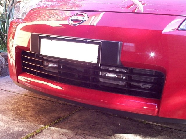

Another

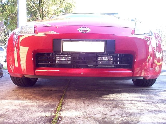

And..

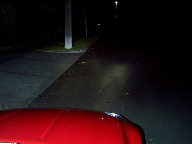

Bottom of the lens has been sand blasted to kill the long distance effect

Some beam patters ( again the camera wasn't very co-operative )

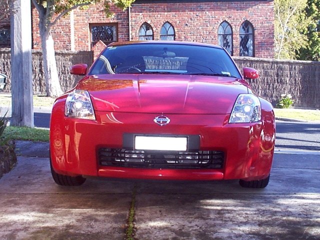

From: Melbourne - Australia

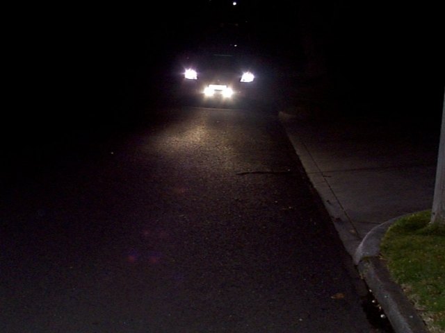

done

arent's those setup will hinder the Power Steering cooler?
Old Sep 29, 2003 | 03:20 PM
REDZED's Avatar
REDZED
Posts: 130
Doesn't block the flow significantly, and I have removed the two blanking plates that cover the outer ends of the grill. The overall intake area is now significantly greater that before the lamps were fitted.
PS I started with 100W lamps but dropped to 55W as I didn't want too much long distance throw.
