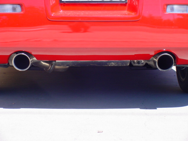

Snowman, Im sure some fugger has already posted this.
Anyway, here's mine!
As always
H

frosty...
Are you using Hi-Tech exhaust as well? How come it looks a bit different from harry's? Your exhaust pipes from the muffler are in black colour instead of publish SS and It is not sitting horizontally though, have you noticed that?
And also does Hi-Tech exhaust have any Logo on their exhausts? what sort of logo do they have? a "kangaroo inside the triangle"??

Yes - is HiTorque - goes and sounds fantastic - especially on full
noise. Highly recommended and I'm pharkin phussy!
Something in production slipped a cog - story a bit clouded -
will report later.
As a result of the stuff-ups youv'e noticed, and my bleatings
(notice the position of the flanges/join and its ugly appearance
and liklyhood of jagging speed humps/RTA and pigs lying on the
road, there's a redesign coming up.
Hold on a couple of weeks and it'll be a more professional unit.
