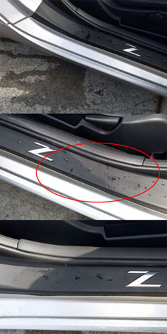

Every time we get a heavy rain, I get water standing in the door jambs. Anyone else get this? You can see in the photos that it's quite a bit of water (spilled on the ground when I open the door).
The water sits on the trim - where the logo is. Is this supposed to be normal? - it's the same both sides. Can see probs arising over time.
Doesn't seem to be any water getting inside the car.

With the rain you had down there yesterday I'd think your lucky if that all the water you had in the car. Hope everyone is OK.
In regards to your issue I do get a little water on there if I hose the car but it's literally only a few drops. If you're getting that much from rain then it may be a problem.

Yea H,
Goin' in for the 20k next week (has it been 20k km's already???!!!). Will get them to look at it. Wanted to find out if it's a universal problem before I talk to the dealer about it.
I get it when there's any reasonable amount of rain or a washing.

Look under door at the hinge end and you'll will find a water drain covered behind a rubber flap/deflector, I think its all part of the design to drain water going in between the door panel and the glass.

Correct and Incorrect.
Don't know about your's but mine's got 2 sets of seals. One on the inside of the trim and one on the outside of the trim. Doesn't seem like much danger of water gettin inside the car but what I'm concerned about is water standing in BETWEEN the 2 seals and causing some corrosion down the track. I think the outside seal might actually be holding the water in.
Also David re: rubber flap, Had a look under this flap and there were no holes. Couldn't actually see a use for it except to maybe prevent wind getting in through the join where the side skirts meet the car. My doors have got 4 holes along the very bottom edge that look like drain holes. And they are OUTSIDE the outermost seals.
