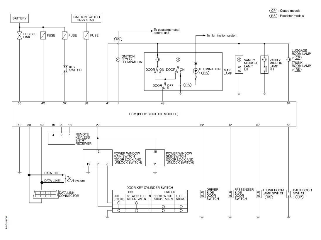

Looking at the wiring diagrams, it appears that the rear luggage lamp is controlled directly by the Body Control Module (BCM). If something internal to that fried, then that would explain the odd behavior with the gauge cluster. The ODBII data lines for the CAN bus also run directly off the BCM. It's possible that when you removed the bare wires, something momentarily shorted and damaged the BCM (sensitive computer module). So prepare yourself, worst case scenario, you may need a new BCM (which will need to be programmed to pair with your vehicle's ignition system - NATS).
