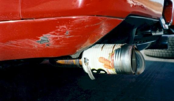

Put the stock exhaust back on when you run Laguna Seca. Some people take orange juice cans to muffle the noise, others make a pipe that points to the left as you saw.. Putting the stock muffler/exhaust on would be the easiest and probably best for HP.
Pineaplle juice can..
V8 can

Hi Steve, thanks for letting me drive your car.
I seriously think that they made a mistake in the sound booth. My last car was louder than yours and I never had a problem. Like you said you definately weren't the loudest car out there. Since you were lifting all day anyways there is no chance of you getting fined. Even if you do get black flagged, you get 3 chances to fix the noise (read, you keep lifting when you go by the sound booth). You only get fined if you ignore the black flag.

I know it could have been an error, but I just don't like that threat lingering above my and I would love to just blow by that booth wide open with no worries. I think I have an idea for a diversion. I'll talk to a muffler shop about it.
I like the pineapple juice can idea!! I'm having a party at my house Monday night, might have to just get some pineapple juice for drinks and save the cans!!!

nice meeting you, also. Well, I also have NISMO headers and RT high flow cats that might be opening things up. I know there must have been some issues, but I hate the constant threat. I went to a muffler shop and they could make a bolt on muffler that utilizes the factory mounts and a magnaflow tube that points the exhaust out the drivers side. I may go with that for $100.

I ran there with my procharged coupe, with the borla headers and catback exhaust, and never lifted throttle and never had an issue with noise. I think you should be fine on noise at LS. The little turn down pipe should be an inexpensive type of bolt on, is often used there, and you just fit it to replace your stock exhaust tips, if you really think you want to go with something else as a precaution. I will be running there again in January with Speedventures, so if I am flagged, will report back that our cars do cross the noise limit. But I doubt it.
