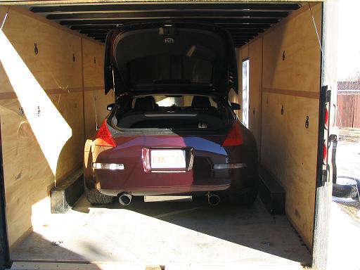

Default This worked great
Best tie down point up front is the tow hook. Use that if possible. When these cars are shipped by train, they use these to tie them down. I bought 2 sets of cheap wheel chaulks (plastic). Placed them front of front tires and rear of rear tires. Took pieces of 2 X 4 and screwed them on the outside of all tires (to stop sideways movement) and other pieces to hold wheel chaulks in place (to stop front and back movement). Sorry that no pics were taken but the car spent 5 hours travelling on some of the worst roads in Northern Alberta. At end of trip, the car had moved approx 1/2".
All out of breath now, going to bed, feellllliiiiiiiinnnnnnnnnnngggggggg d i z z

FibreGuy
You really don't rely on one point tie down, Do you? The Z moved 1/2" on a 5 hour trip should tell you that that is just asking for trouble. There is not much room between the wheel wells and the sides of your car in that trailer.

The 1/2" of movement was actually forward in nature. The side movement was held to zero by the 2X4's screwed nxet to each wheel.
