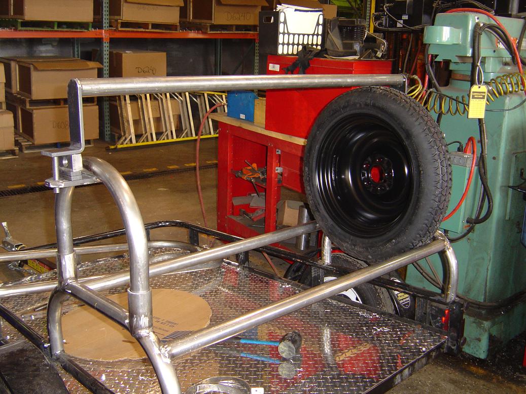

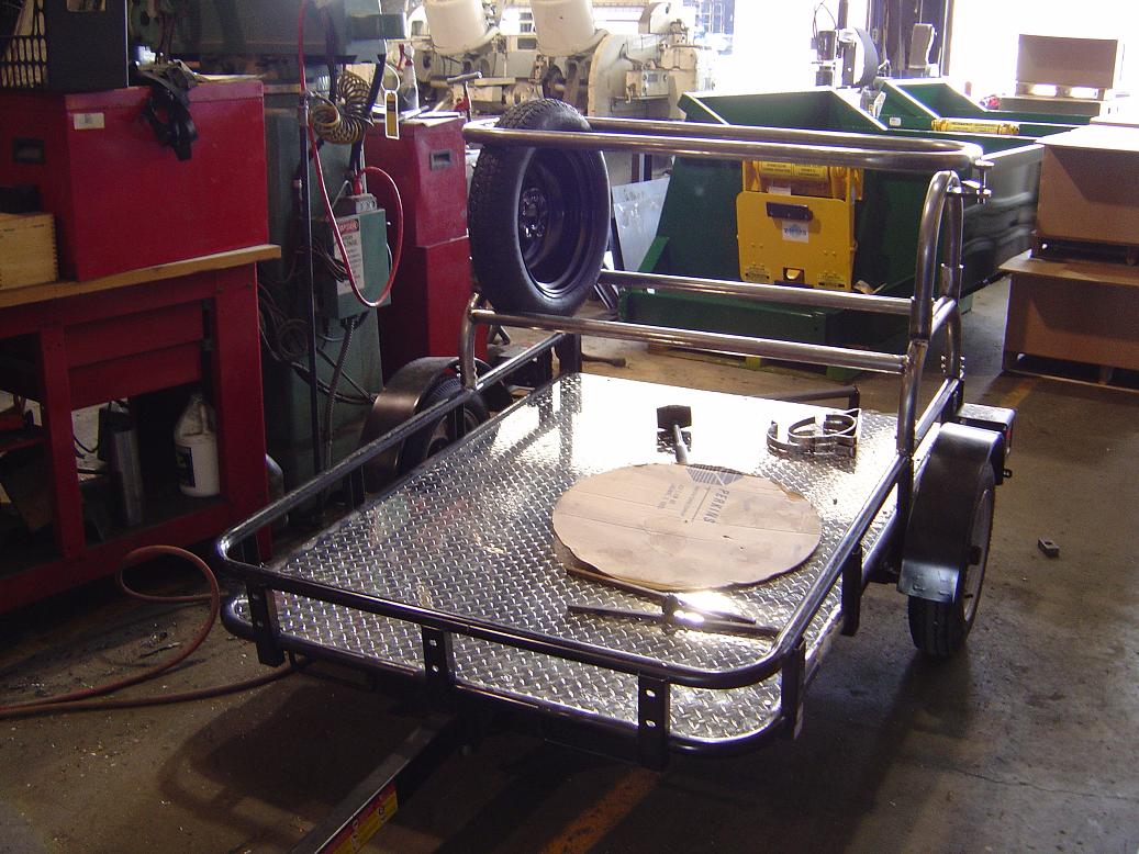

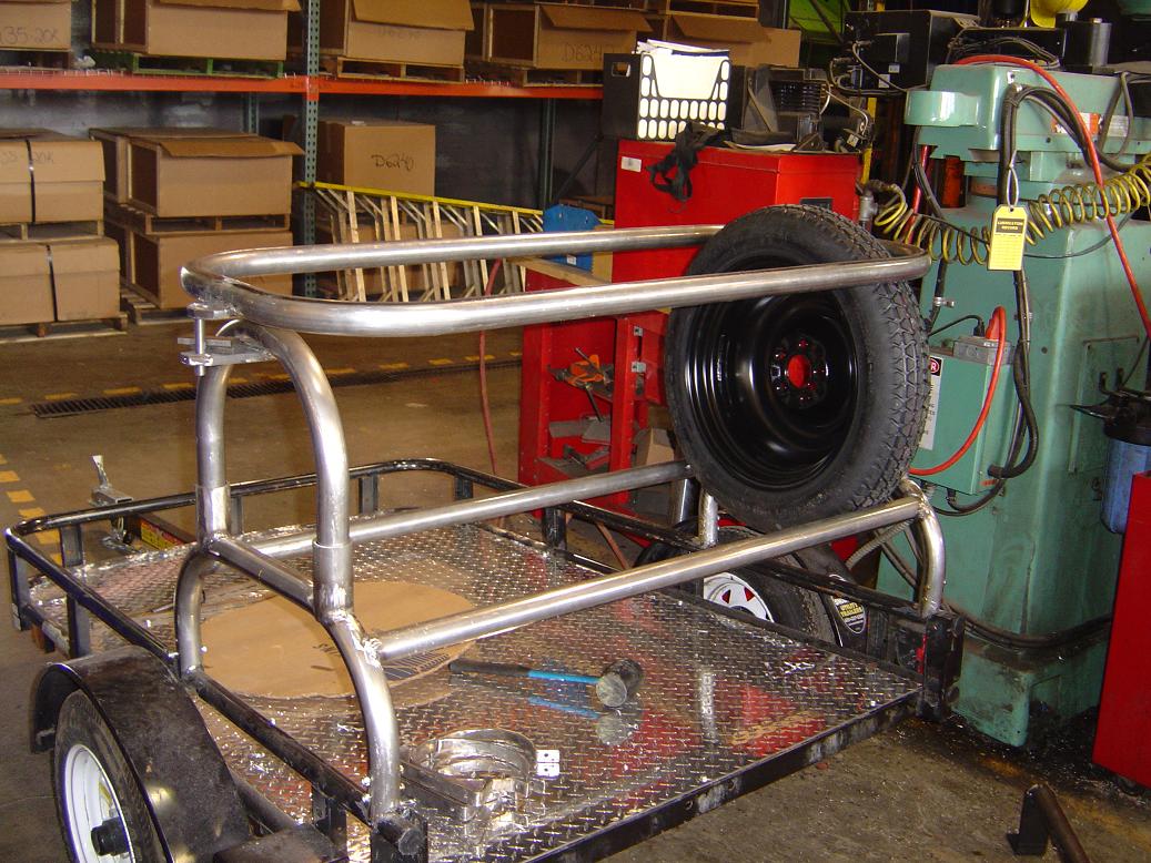

Work has been busy, but I was able to find some time and get the shop guys onto my track trailer. I'm undecided on the way to secure the tires. Which is better (see photos)?
With the dual bar retainer, only 41" of the 48" total trailer width can be used because of the tube bend. However, if I go with this design I will have them make it with no bends (miter cut it). They are also making a combination one for me to see. Essentially, there is two bars 6" apart connected to the vertical peice that is tightened to the main frame - yeah I know, I can't explain worth a poop.
I've got a plastic type tool box, 3x3x2, a 180 cubic centimeter nitrogen bottle and my ez-up 12X15 tent to add.
Anyway, which design do you think is better? Why?

Neither. Fab up a bar that attaches to both ends and goes through the middle of the wheels. Done deal.

FWIW... of the two designs you showed, I think the dual-bar way would be the safer way to go. Only thing that would worry me is relying on the securing bolts to take all the forces of holding the wheels in place. If one of those bolts breaks or comes loose, there go your wheels.
If you go with a 'bar-through' design, it could be designed to simply secured with large removable cotter pins, with the bar and framework holding the wheels in place, not the securing screws... the cotter pin would be simply to keep the bar from sliding out

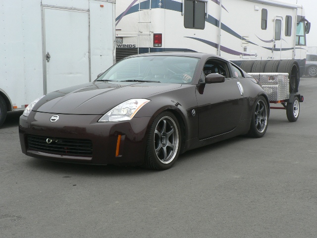

Default Picture of car and trailer at Laguna Seca
Well balanced about 70 lbs on the tongue.
