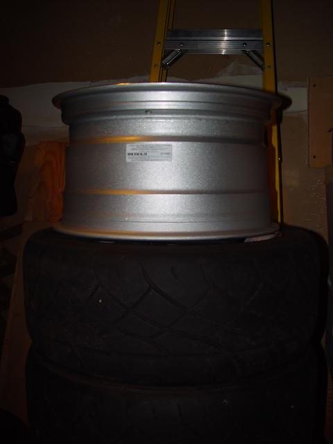

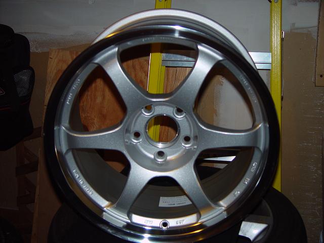

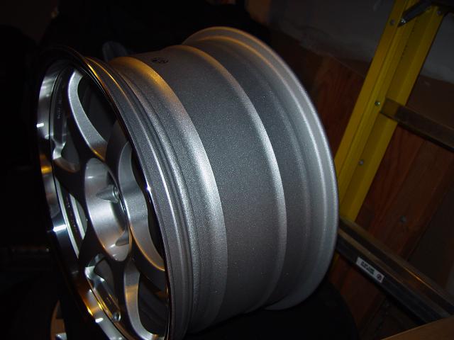

The deed is done My 17x9.5 SSR Comp H's are here! Now if only I had tires for them... 9.5" is WIDE!
ahm
Attached Thumbnails 17x9.5 wheels all around?-dsc01088_small.jpg   17x9.5 wheels all around?-dsc01089_small.jpg   17x9.5 wheels all around?-dsc01090_small.jpg

Congrats, that is a smoking deal on SSR Comps.
