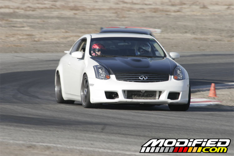

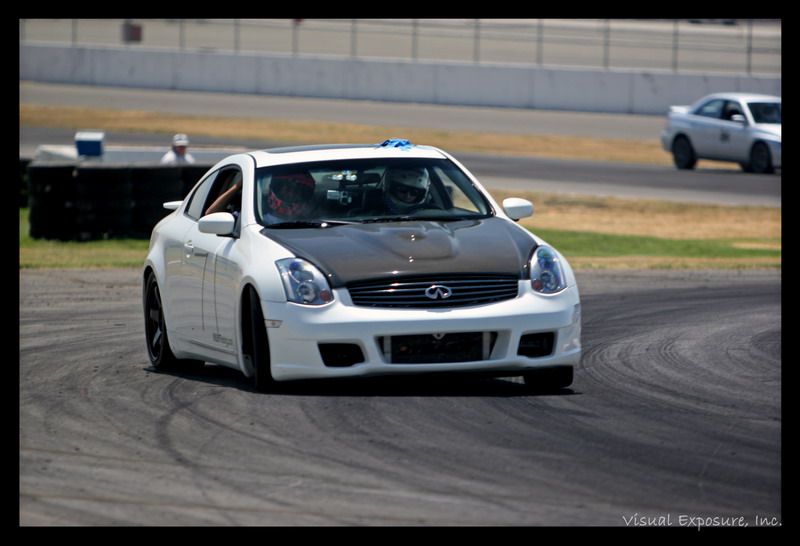

Not too much to say. We have built many Z's G's in the past 3 years, ranging from very mild daily drivers, to full blown track cars. The Eibach Sportline springs are as good as any other stand alone spring on the market for daily driving street comfort, especially considering the agressivness of the drop. The Tokico D-Spec is a price friendly 12 way adjustable that complaments the dprings well. I have one of my personal cars (a G coupe) with this set up, I track the car quite often and am very content with the overall drop, ride height, streetability, and track performance. Granted they are not better than most coilovers, and they are not a linear spring which are ideal for track use, but the over all result is a nicely priced shock/spring combonation for the street, that will work fine on the track.
Here is a couple pics of a Z (Navyfolf) we did on Tokico/Sportline and my G.....
Attached Thumbnails Suspension Poll: For HPDE & R-comp on a daily Driver-_mg_0340.jpg   Suspension Poll: For HPDE & R-comp on a daily Driver-cal_bs.jpg   Suspension Poll: For HPDE & R-comp on a daily Driver-_mg_0785.jpg   Suspension Poll: For HPDE & R-comp on a daily Driver-cal_02.jpg   Suspension Poll: For HPDE & R-comp on a daily Driver-pm_show.jpg
