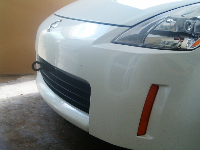

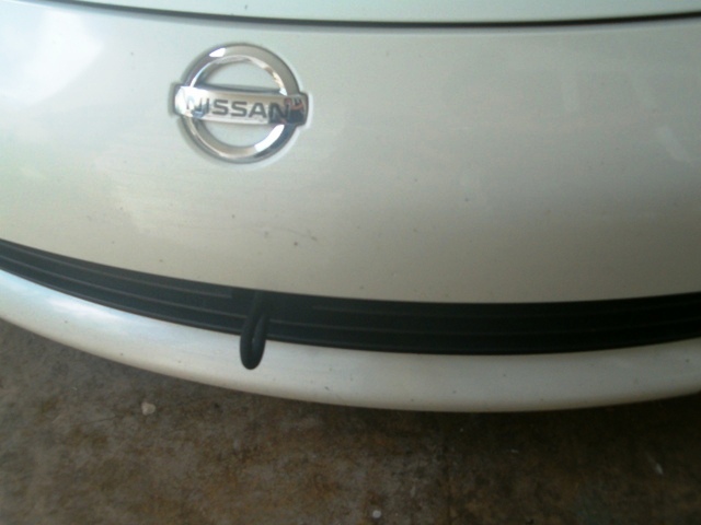

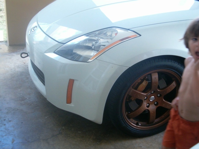

if you put a washer in the tow hook yo can torque it perfectly perpendicular to the ground and looks better. also you can powder coat it red or black and looks better also. here's a few pics.

Ouhhhh weee, that is sexy.

Definitely looks nicer!
