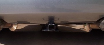

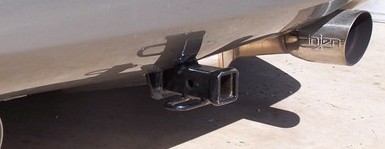

Here's the hitch that I installed this weekend. It took me a couple of hours since I had to remove the bumper and the support beam to bolt the hitch. I had to cutout a small portion of the bumper on the bottom center to fit the receiver portion of the hitch. I ordered the hitch from eTrailer.com:
http://www.etrailer.com/hitch-2006_Nissan_350Z.htm
have any pics of it installed? I really don't want to cut the bumper to make this fit...

I'll take pics tonight . . . you really could not tell the bumper is cut because the hitch is there. And it was only a small cut - 1 1/2" x 1 3/4".

Does it connect just to the bumper reinforcement (the "inner bumper"), or to the unibody too?

Just to the bumper reinforcement. The hitch is well-designed, and is installed solidly on the bumper. In addition, I made sure the trailer I bought is lightweight but had enough load capacity to haul the tires & a toolbox. Realistically, once you're on the road, the hitch/bumper itself should not have a lot of stress on it. You just need to make sure to compensate for the additional towing weight by accelerating and/or slowing down more gently. I'm used to towing trailers/boats/jet skis in my pickup truck so I'm aware of what can happen if you exceed your limits.

Here are a couple of pictures of the hitch that I installed this past weekend:
