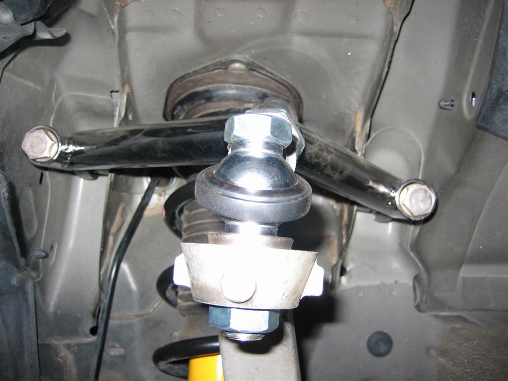

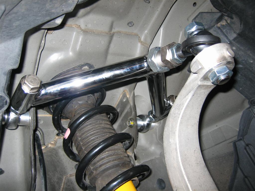

I have the race spec SPL upper A-amrs.
Well built, sturdy adjuster, steel bushings everywhere.
I don't think any other arm allows for so much negative camber (-4 degrees)
I'm running about -3 dgrees now.
www.splparts.com
Attached Thumbnails rear toe arm options / brands?-img_0800-large-.jpg   rear toe arm options / brands?-img_0729-large-.jpg   rear toe arm options / brands?-img_0704-large-.jpg   rear toe arm options / brands?-img_0703-large-.jpg
