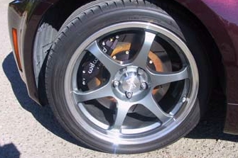

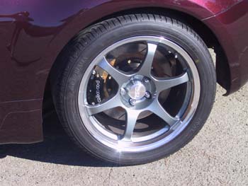

Old Feb 10, 2008 | 06:35 PM
  #67
C Ray Z's Avatar
C Ray Z
Posts: 449
From: San Carlos
Default Photos of Wilwood Kit
See photos of the Wilwood Kit. These are 18' but my track wheels are 17x9 with 275 Nitto 01
Attached Thumbnails Brake question for track warriors-102-0274_img.jpg   Brake question for track warriors-102-0279_img.jpg   Brake question for track warriors-102-0275_img.jpg
