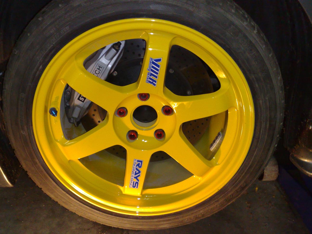

just want share these with you guys.
i just bought a set skyline setup for my 350z,
track use only.
17X10 +12 all 4s.
and fitment is perfect.
Attached Thumbnails 17's and BBK's???-20080611339.jpg   17's and BBK's???-20080611335.jpg

^what size is your BBK?
do u have a front and rear set-up?
Old Jun 12, 2008 | 07:00 AM
marcelz's Avatar
marcelz
Posts: 218
From: 98230
st40/st45
fit both front and rear.

are the wheels a custom set-up?
i seem to be able to find 17x10 +18 or 17 x 9.5 +12
Old Jun 12, 2008 | 09:28 PM
marcelz's Avatar
marcelz
Posts: 218
From: 98230
**+18 offset
