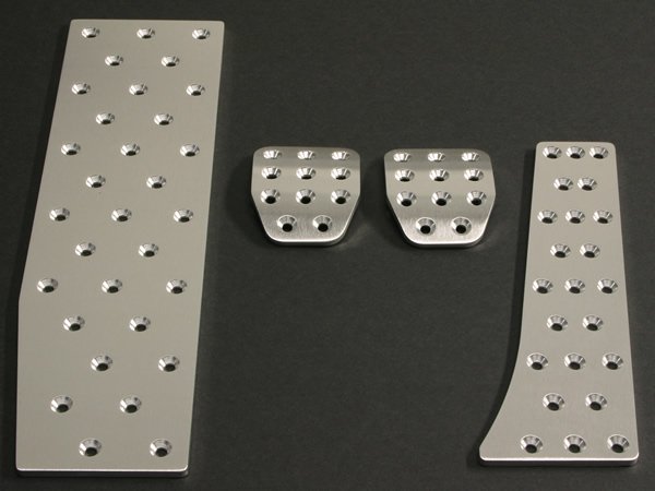

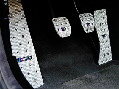

Different styles available, but here are a few pics. Not all have the extensions.

I got my pedals from Autovation. Here is their website and a picture of my pedals. They definitely make heel and toe shifting much easier.
Les
http://www.autovation.net/
