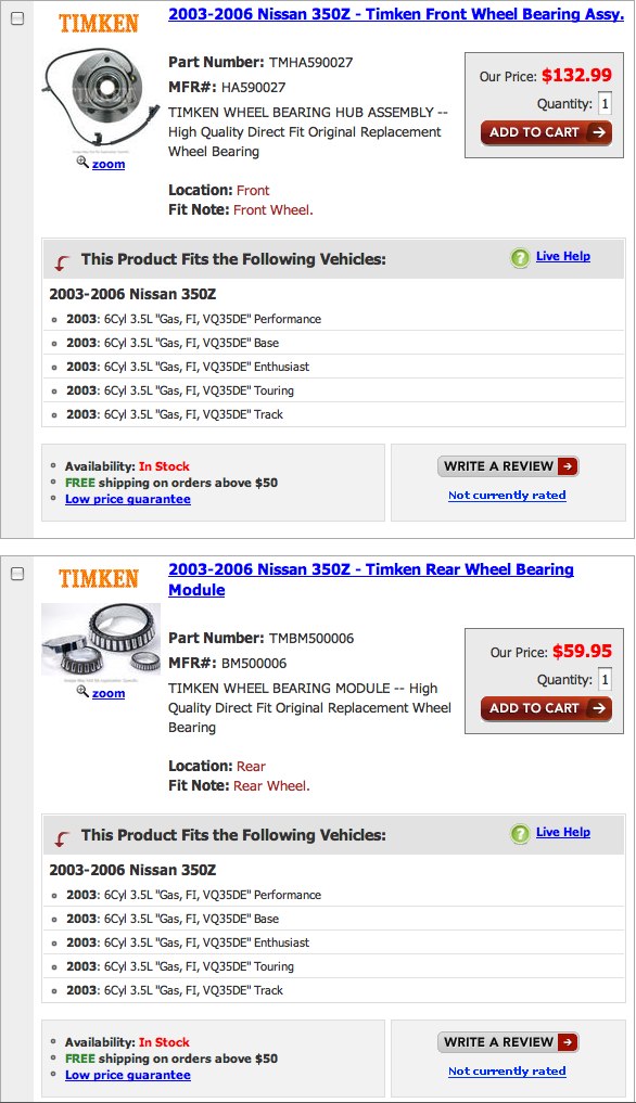

I got my front and rear Timkin wheel bearings from www.autopartswarehouse.com but I am sure many places sell them.
Timkin front = HA590027
Timkin rear = BM500006
These parts number came right off the Timkin labeled boxes...
You may want to check to confirm what years this fits... but I believe they fit 2003-2006, but maybe later MY..dont know for sure.
hard to beat these prices!!
