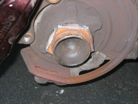

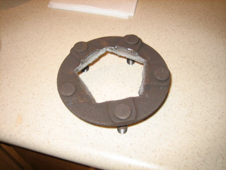

My front left hub came apart on track a few years ago: the casting broke and a pentagonal piece with the wheel studs just separated from the rest of the hub. I don't recall hearing anything. The handling just got strange, and I slowed down and came into the pits. At that point, the only think holding the wheel on the car was the rotor in the caliper.
First time the Z had to be towed home from the track. Fortunately, it was Summit Point, my home track, only 75 miles from home.
If I can find the pictures I took, I'll post them.

Here are the pictures. I didn't describe it quite correctly: the ring holding the wheel studs separated from the hub, leaving a pentagonal hole.

that almost looks like it was cut

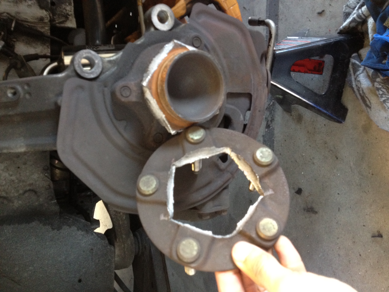

I had the same exact failure this weekend. . .

I had to buy a new one from Nissan so I could continue driving this weekend.
