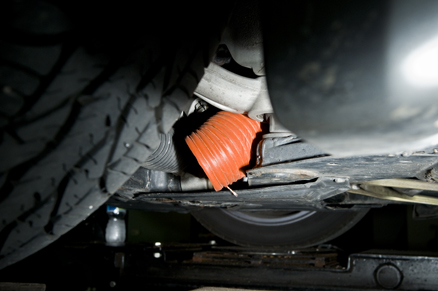

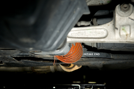

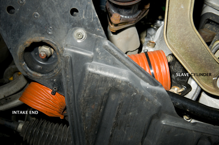

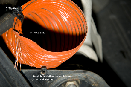

Morris's heat shield idea was a great suggestion and I think that definitely would work for anyone since it worked for him. We went with the easiest and quickest idea by placing a short length of brake ducting hose connected to the sub frame with the intake dipping just below the rear plastic cover under the car into the air flow and the other end right on the slave cylinder. Just finished an 85 degree track day with a mid-afternoon run of 35 minutes with no issues.

Here ya go, Jason.
Attached Thumbnails Track Day Clutch Fluid Problem-duct73.jpg   Track Day Clutch Fluid Problem-duct75.jpg   Track Day Clutch Fluid Problem-duct78.jpg   Track Day Clutch Fluid Problem-duct79.jpg

Thanks for the pics....cant believe that worked that well. I guess I am going to have to try it.

Yeah, I know what you mean. It's not like it's a big ol' naca duct in the grill or something but so far so good. I'm interested in this heat shield that apparently is made for the slave in the G35, but not so interested in spending $90 if $5 of ducting continues to work.
