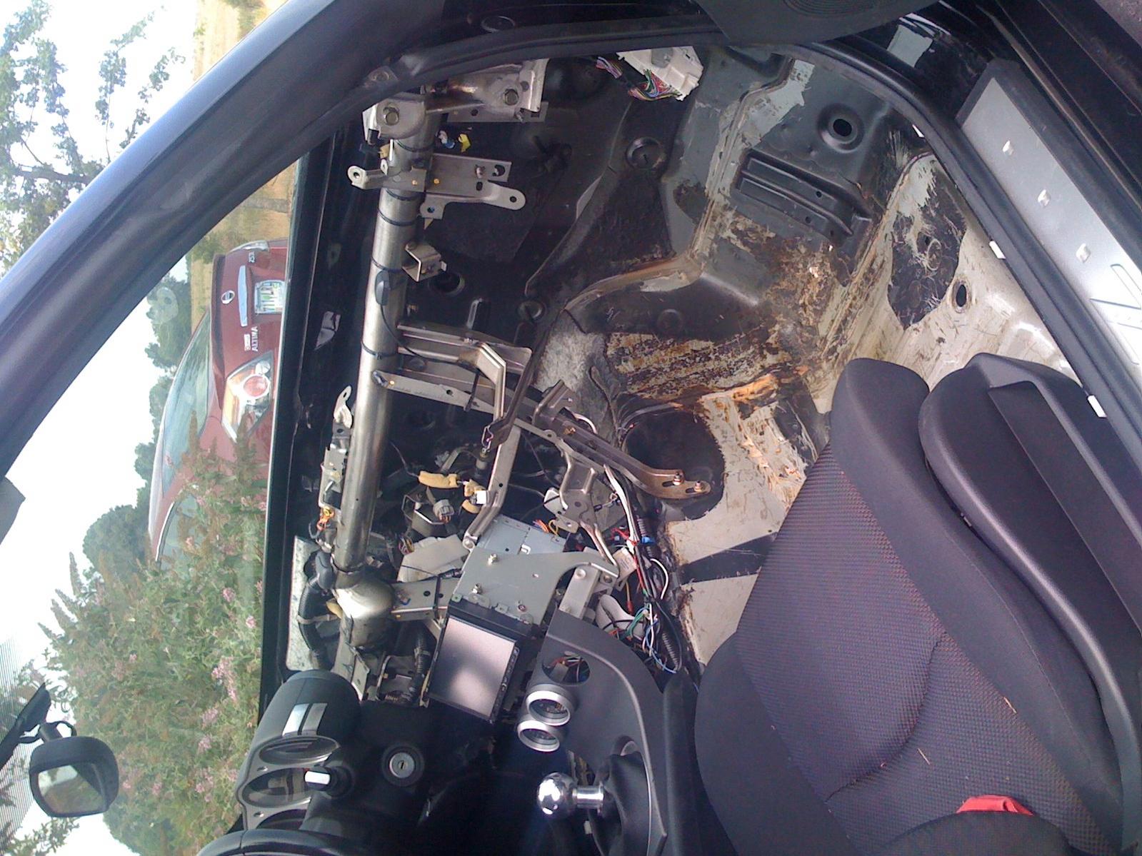

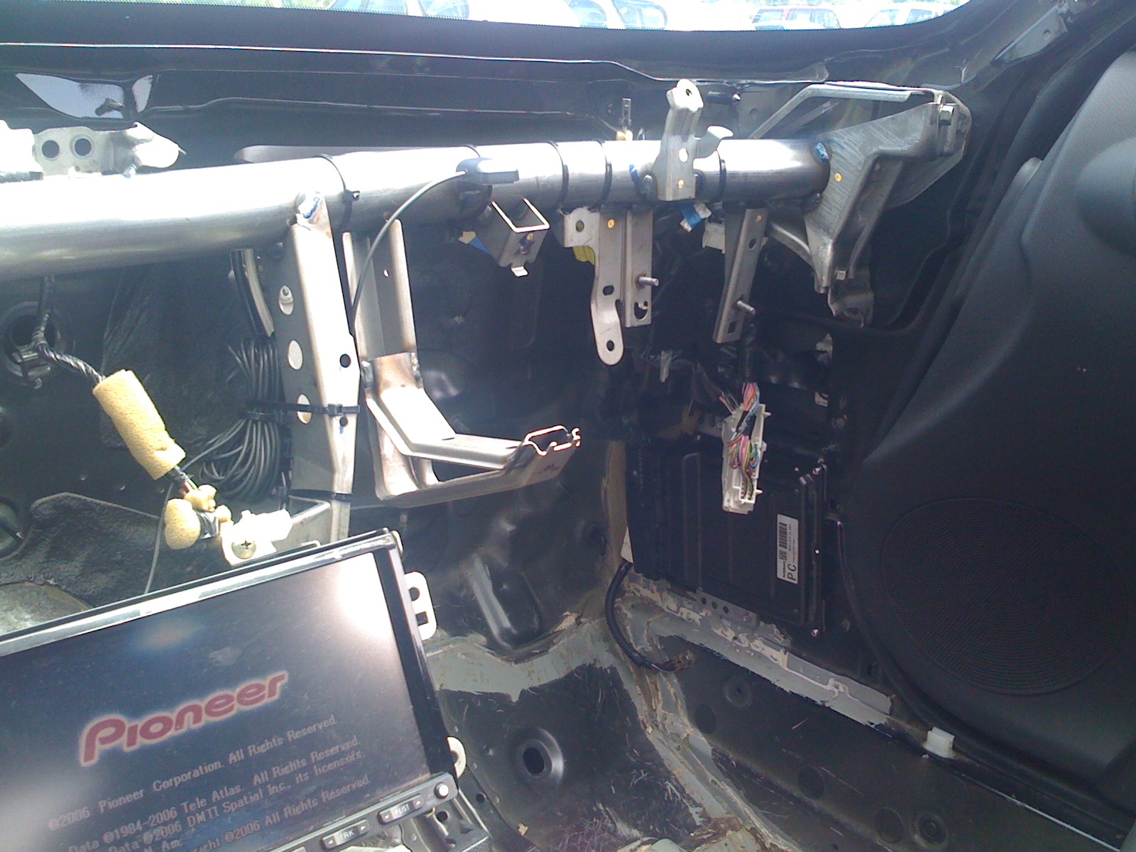

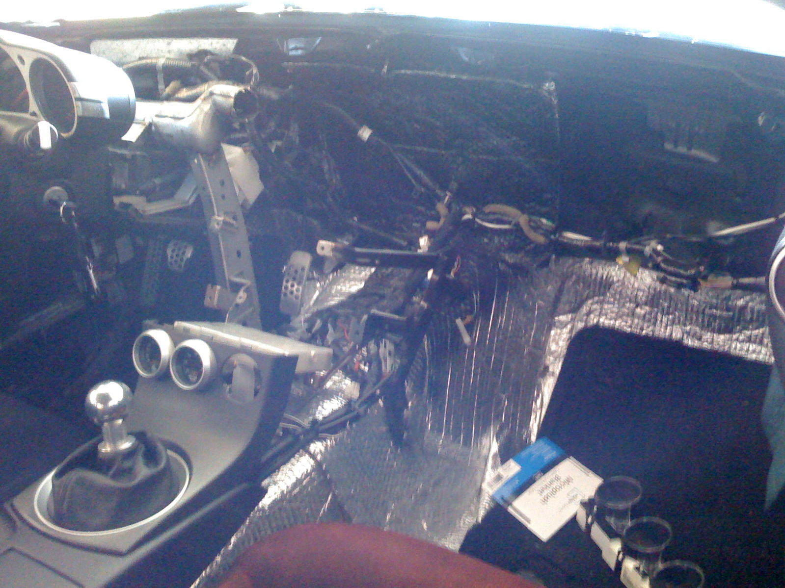

awesome info guys, keep it coming! anybody know if some of the wiring, etc can be removed? i seem to have a bunch of extra wiring laying around in this car.
Depending on what you have removed is what you can unwire. Basically any unconnected connector, you can start cutting the loom and tape and trace it back. It is a real PITA to do it that way, but it works. I still need to strip out the wiring for the HVAC, airbags, stereo, rear defroster, etc...
The only thing that I need left wired up are the Speedo, tach, fuel gauge, and the tail lights. If I remember right the fuel sender goes through the white plastic box that sits under the radio area.
this is my interior, in several stages. More to go later

Might as well pull the yaw sensor and harness out while you are at it. If you want to go real hardcore, pull the BCM out and all of that wiring and just use a pressure switch for your brake lights, and the rest you don't need. Go with an after market fuel level sensor, pull the solenoid for the hatch and go back to just having a cable release, or even more hard core and use quater turn fasteners. Also pull the quarter windows for lexan but integrate a NACA duct, you'll need it.
YOu can cut the engine surround out, it is ornamental anyway, solid motor mounts gnerally weigh less than the dampened style and are pretty cheap.
Test pipes weigh less than cats and single exit exhaust
I would keep the OE Brembo rotors, I've tried the Stoptech 2 piece rotors and was not impressed. I'll sell you my fronts if you want them.
You could pitch the OE strut bar, I doubt any of us on this forum could tell the difference if it was there or not.
Headlight deletes save some weight, maybe a couple of pounds, I'll weigh mine next time I do the swap.
Cheap bang for the buck is swapping the rear hatch glass for lexan, I think it is only a couple of hundred bucks for the lexan and that is a huge weight savings, also good to have the metal hatch if you ever plan on running a real wing that generates downforce.
That is about all of the cheap stuff, lemme know when you want to blow through some money. I save 23 pounds by swapping bolts. There are also other ways to blow through some cash, but that is later.
One thing I would HIGHLY recommend is swapping the lug studs on a track only car. I run the ARP subby lug studs. I have seen the OE studs several times and even the Nismo studs fail. they are ~$10 @ but I trust them.
I also have a set of Xerd headers I could sell you real cheap, they are the long tube style, which includes the header and test pipe, they are lighter than a manifold/TP or even a shorty header/TP setup. Any weight you can get out of the front is a plus.
