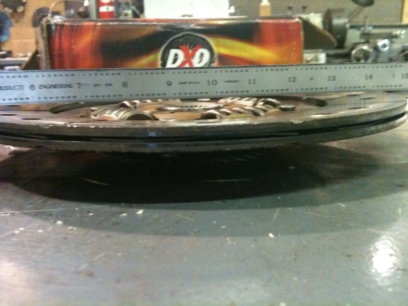

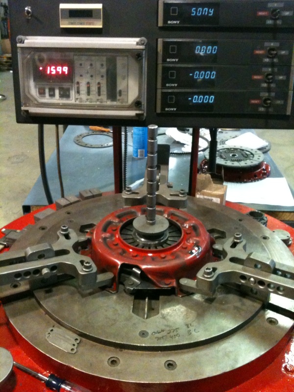

I'd be more then happy to take a look at the clutch if you have any questions about it. I can give you actual plate load, clutch release measurement. I can also check for taper in the flywheel/ pressure plate from warp. For free of course. (SEE PICS)
FYI, I'm not trying to sell anything, just trying to help a fellow enthusiast get his problems figured out.

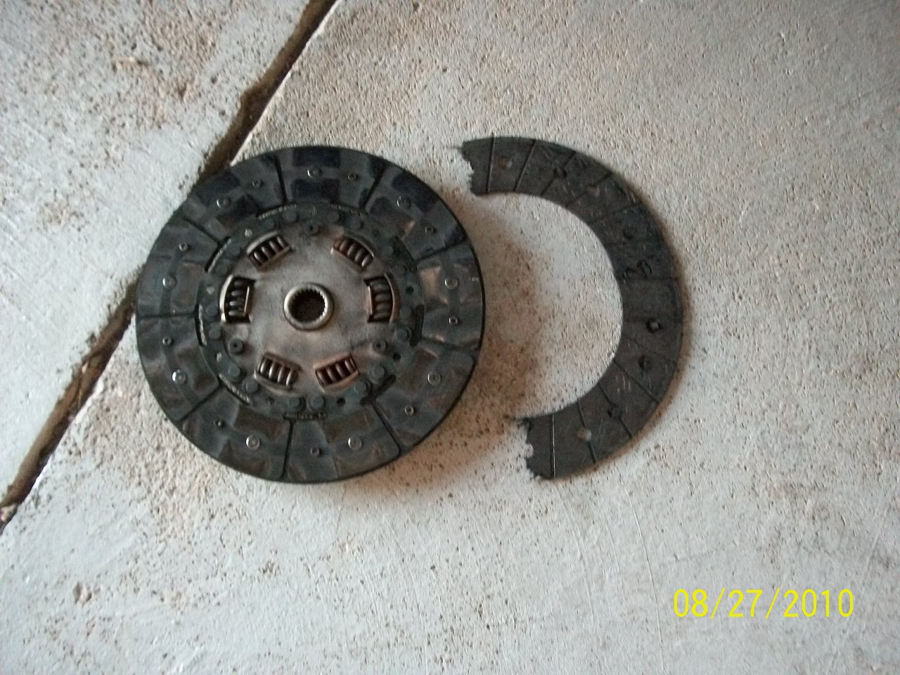

Well I finally got the tranny pulled and um....yea. The damn friction surface on the clutch pretty much just broke down into pieces and flakes. The pic shows the piece that stayed in tact. It was loose anyway. When I pulled on the pressure plate the leftover friction surface just fell out. Good stuff. Needless to say, I'm ordering a new clutch.

Well, I have an RPS segemented flywheel and I think their clutches only work with their flywheel. The flywheel looks good to me. I am going to replace the friction surface on it and get a pucked clutch from them. I pretty much just road race the car. I almost never drive it on the street. I will have to though to break in the new clutch.
Also, the forks on the pressure plate are bent pretty bad.

Even given the abuse....I would be hard pressed to put another clutch of the same brand in after that result. Just my .02.
