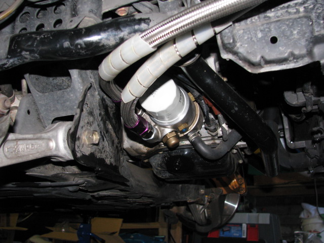

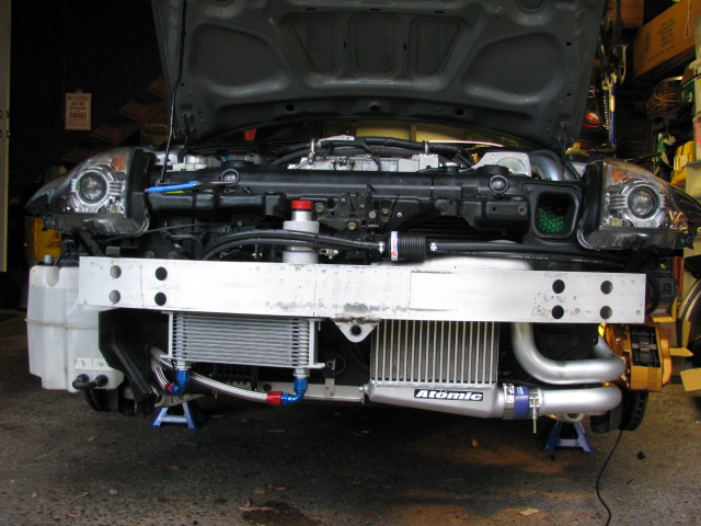

Here's a pic of my oil cooler-
Fittings are Earls -10, 2X straight, 2X90deg
HKS sandwich
Earls 41310 ( Earls demo'd this size on Chev V8 )
I did the fitting while installing a HKS S/C. I used S/S bolt and nut to attach to the bottom of the bumper. The facia needed a bit of trimming on the inside for clearance of the cooler
http://images.ibsrv.net/ibsrv/res/sr...attach/jpg.gif
Attached Thumbnails Oil Cooler Suggestions-img_2947.jpg   Oil Cooler Suggestions-img_2943.jpg
