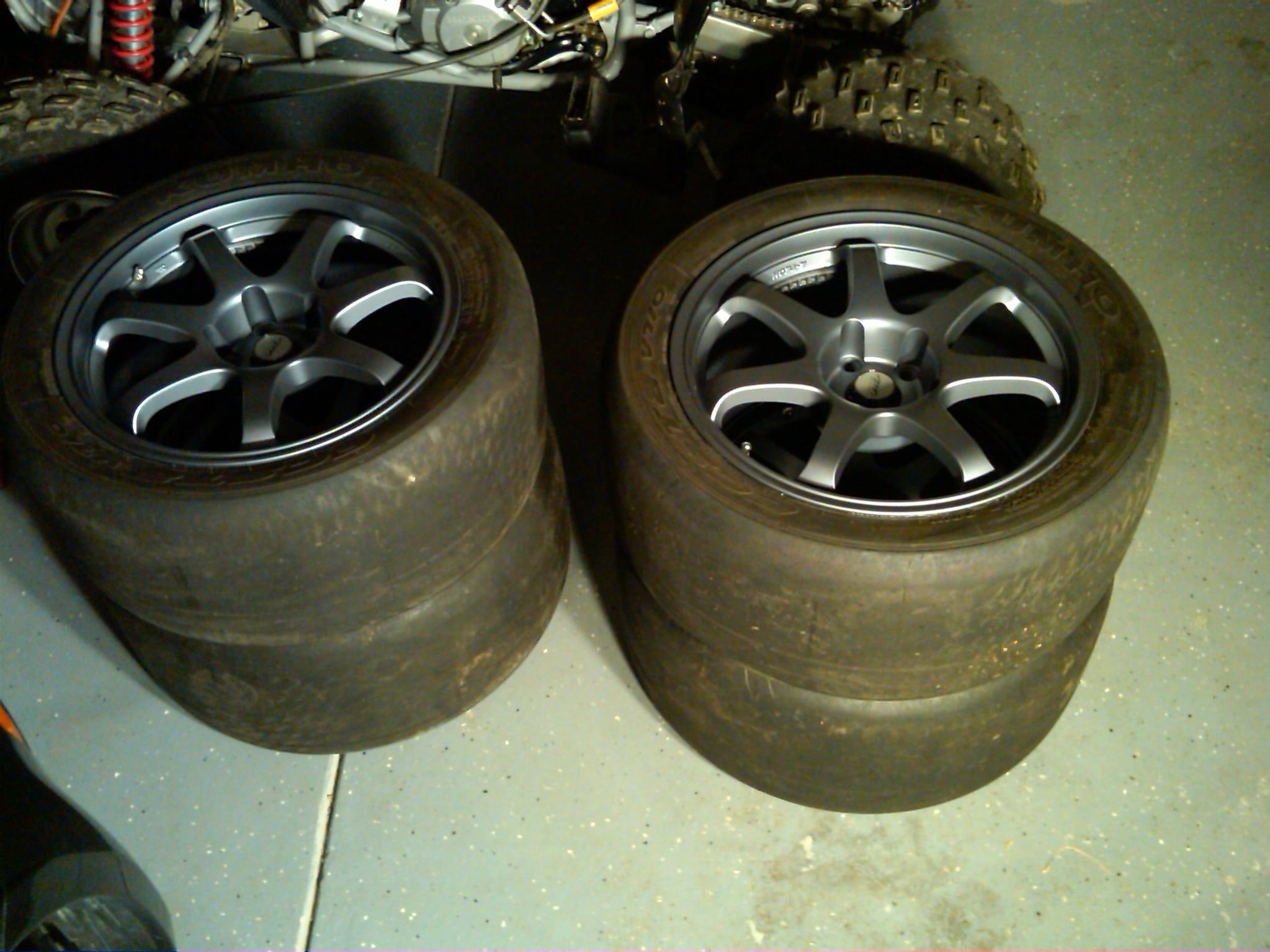

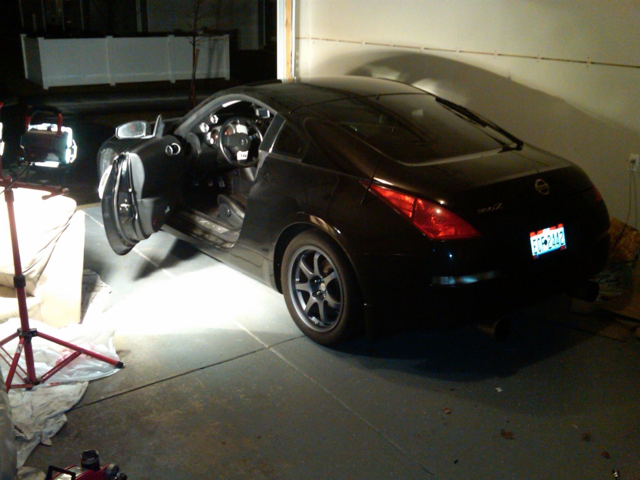

Default Put them on my car today, here are some pics....
....By the way, these things are light! Compared to my stock rims these felt so good.
